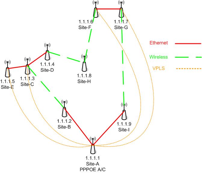

Please have a look at my attached network layout
Basically, sites C,E,F,G all have a VPLS tunnel to Site-A which is the PPPOE A/C
The below attached IP’s are the loopback IP’s
OSPF is running between the Sites
Do you have any tweaks that I could apply to the below setup?:

I was reading this page about MTU: http://wiki.mikrotik.com/wiki/MTU#VPLS_ingress
For VPLS, should the MPLS interface MTU be set to 1508 or 1512?
I assume you want to avoid fragmentation. Then mpls-mtu of outgoing interface (the one over which VPLS encapsulated frames will get sent) should be set to: 1514(ethernet frame)+4(vpls control word)+8(2 labels)=1526. Note that all routers in MPLS cloud should be configured with the same mpls-mtu. Also remember that you should not configure mpls-mtu that would exceed l2mtu.
Thanks mpls guy.
I have just noticed that I am using RB433 and some sites are joined via ether2 which has a max MTU 1522 compared to 1526 of ether1…I have 3x RB433 linked at some site, hence why ether2 is used
Would it be advantages for me to rather use RB600’s? Would I see an improvement?

It depends. The difference will be in amount of frames forwarded across network - assuming that you will transport full size frames across VPLS tunnel, you will have 2 times more frames if you use devices that do not support big enough l2mtu (because every big frame will get fragmented). I guess you should decide based on wether your current bw requirements for network are close to its capacity and what are your future plans. If, let’s say, only 20% of your available network bandwidth is used, it is fine to go with fragmentation, if you already are at the network capacity limits (especially number of frames it can forward), you should see improvement. If you have wireless links as part of your MPLS cloud, I would strongly suggest avoiding frame fragmentation. Also take into account that l2mtu of 1526 bytes will not allow to transport full size ethernet frame with VLAN tag over tunnel w/o fragmentation - if you plan on doing that, it may be good idea to use devices that support jumbo frames.

I have wireless and ethernet links as part of my MPLS cloud but I do not have VLAN tags, so l2mtu of 1522 should be fine right? I do run pppoe over the VPLS tho
Doe MPLS TE tunnels add more overhead than the 2*4= 8 mpls bytes?
Like I said, you need l2mtu 1526 for VPLS forwarding 1514 byte (1500 bytes data + 14 bytes ethernet header) ethernet frames.
TE tunnel itself adds just one label (4 bytes), so it does not matter (from frame size point of view) if you forward VPLS across TE tunnel or across LDP established LSP.
Thanks for the clarity, however, I am running VPLS over LDP with an l2mtu of 1522 and the VPLS tunnels still work. Does it by default drop the PPPOE MTU to 1476?
EDIT: I just did a ping test, over the pppoe over the VPLS without fragmentation, with a size of 1480 get I reply
I don’t know to what exactly you refer as “PPPOE MTU” of 1476 bytes, therefore can not comment on your PPPoE case, but you can easily calculate resulting size of packet knowing what headers are added.
RouterOS VPLS implementation automatically fragments (and reassembles at egress point) packets that exceed mpls-mtu after VPLS encapsulation. Therefore it will work, but fragment packets - you can confirm this e.g. by watching number of outgoing packets.
