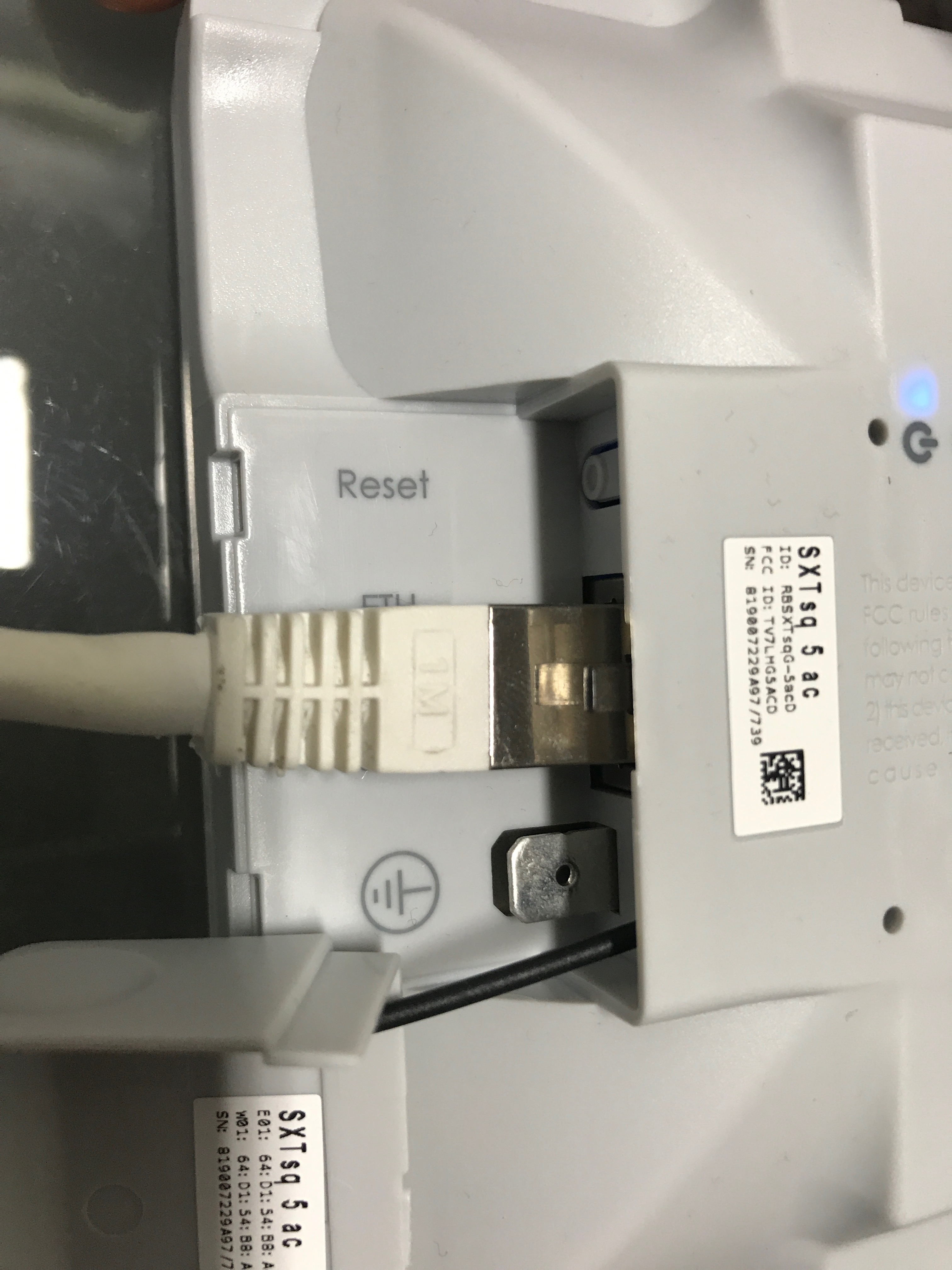

Same Issue on SXTsq AC
SXT is outdoor product. Most customers use an outdoor FTP cable. Crimped to the desired length…
My Jacks with kink protection don’t fit
You can use a knife to cut off few millimeters part of the cable protection. Or use connector crimpled to cable without it.
But why Design is going backwards?
The first Sxt Models had this issues too, and some models later the Ethernet plug ist played better on the pcb… and know Same fault again, have they learned something in the years between?
You can put whatever on the cable and say it cannot fit. You can always find a cable with longer bending protection that will fit anywhere. Just cut it off and make new connector there. I can’t understand how it could be a problem.
