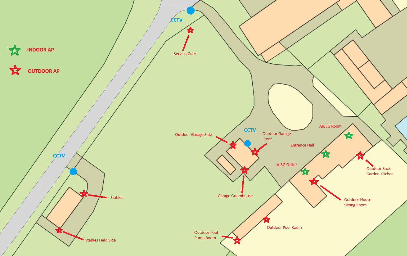

Hello all, I looked at a few posts trying to find a guide that could help me understand the complexity of moving from a relatively simple, but flawed, GUI based Controller (Unifi) to RouterOS to manage the APs.
I have 13 APs distributed on a 3 acre site, the complexities I need to manage are basically 2:
  1. 60+ IoT and CCTV devices which are only 2.4GHz capable, need to be able to lock a device to a specific AP
  2. 10+ modern phones/tablets (802.11r capable) devices which require fast handoff, high throughput, (min Data) as the are has no cellular signal so relies on data calling
Centrally I have an older CCR 1016 running v7. Across the site all switches are dumb and of various makes (Netgear, TP-Link, etc).
Conceptually I think I will need:
3x Chateau PRO ax
10x wAP ax
Any advice would be gratefully received. Thank you.

It is not clear on your diagram
a. which sites have an ISP modem/router
b. which sites have 120V power
c. which sites have ethernet poe capable cabling
d. which sites expect a wifi link for connectivity ( no cabling ).
I personally not being a wifi guru or wisp expert but generally speaking,
use 60ghz devices to connect gate and stables and garage/greenhouse to main location ( assuming not wired for ethernet )
https://mikrotik.com/product/wireless_wire_cube_pro
Then in terms of using local APs, I would not necessarily look only at MT,
unifi, grandstream, zyxel may be others that provide better performance, however you will get varied opinions.
