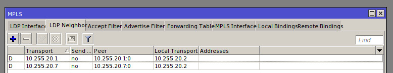

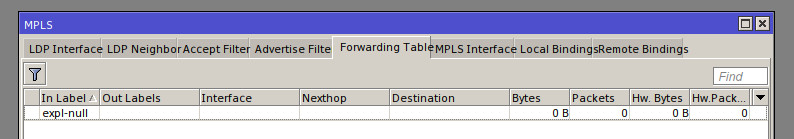

The reason is to consult the following, I have a network of several nodes which I am migrating to OSPF + MPLS + PPPoE + Vlan (per node), at the moment the network is in bridge mode and in each AP I have assigned VLan + dhcp from the edge router that is in my office, the point-to-point links are with the AirFiber and Mimosa computers which work well, the problem is that the OSPF works well but what is MPLS does not work, does not mark anything, I already made a small practice with the GNS3 to see where I’m making the mistake but the same thing happens to me, in the Forwarding table of mpls I do not see anything but in LDP Neighbor if I recognize the teams that have in front and behind that are the AP with a Vlan and another router.

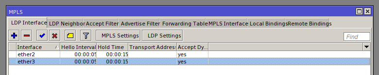

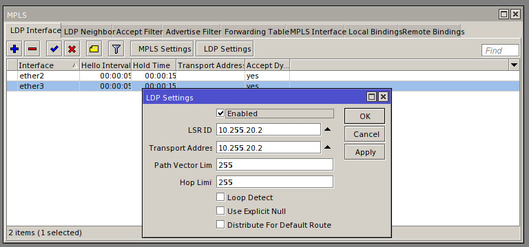

Did you enable mpls on interfaces?
Attached capture of what is in mpls, until what is mpls is not more science but the truth is because I do not mark anything, in the capture can be seen, even in the tab “LDP Neighbor” you can see two neighbors but the strange thing is that it disappears every moment, I have a point-to-point link with vpls and in this one it works fine, the configuration I’m doing is to apply ospf + mpls between my nodes.

I solved, now if you mark me the tables normally, human error
