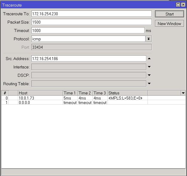

I have 5 routers properly configured with OSPF, MPLS and LDP protocol with an MTU of 1516 on all routers, apparently the MTU would be correct as reported by the ROS in the l2mtu.

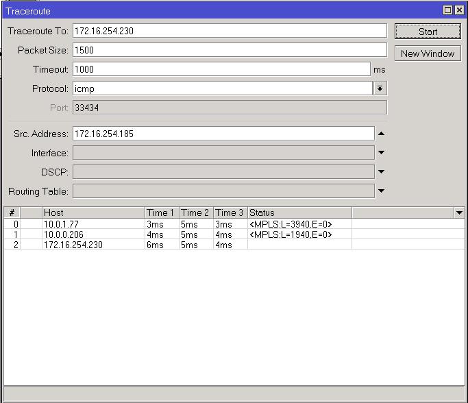

traceroute from router1(rb433ah ros 5.0beta5, running ldp only over wlan1) to router5:
traceroute from router2(rb433ah ros 5.0beta5, running ldp over wlan1 and eth2) to router5:
traceroute from router3(rb433 ros 4.9, running ldp over eth3 and wlan1) to router5:
[admin@router3] > /tool traceroute 172.16.254.230 src-address=172.16.254.158 size=1500
ADDRESS STATUS
1 10.0.0.206 5ms 4ms 3ms
mpls-label=1940
2 172.16.254.230 3ms 6ms 3ms

why this setup fail only in one way?
