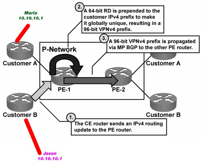

With according to the diagram picture i attached, how PE-2 router will find customer A want to communicate with Maria not Jason??!!?! :open_mouth:

look at your diagram from first post
Customer A and customer B are not directly connected so they do not know that both of them has the same address. PE-1 router decides to which customer A or B packet should be forwarded.
yes, but imagine that if a packet sending from one of right side networks , and want to call with 10.10.10.1 then what will happen? :question: :unamused:
let me explain step-by-step, the customer right A wants to ping customer left A, for example. when the information come into PE2 the PE2 will put that information in an exclusive routing table(VRF), this routing table will be propagated to the PE1 using the facilities of MBGP, the PE1 also have an exclusive routing table, where the interface that goes to customer left A was added, what happens in the same way on the PE1, so the PE2 knows how to send using the correct interface. because of that there is no importance if the clients that are using the same network address if they are clients of the same PE router.

He explained to me if right side PE router import both VRF tables to a customer router then there is conflict between IP addresses and it is natural.
