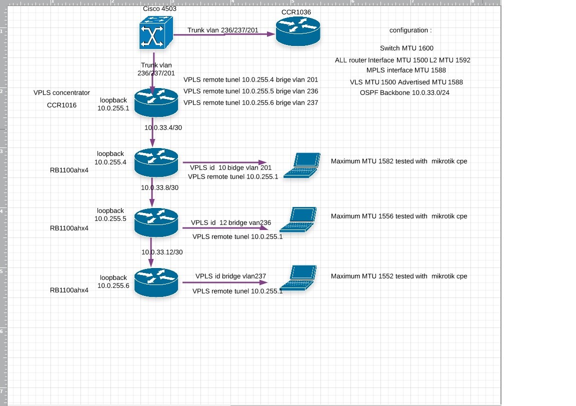

Hello, i need a small help regard a mpls lab i have created . CCR1036 is pppoe concentrator . After all configuration before to activate mpls i have done tests with ping do-not-fragment with 1588 value from every router 1100ahx4 in the scheme its ok . After this i activate mpls and create vpls tunels from each router to vpls concentrator i cant ping any more with higher mtu. what is strange that i lose bytes on every hop …
from the first 10.0.255.4 hop i can ping with do not fragment with 1582 , from second hop 10.0.255.5 with 1556 and from third hop 10.0.255.6 with 1552 .

VPLS concentrator ROUTER > To-R1 > To-R2 > To-R3 > To-R4

Router R1 R2 R3 R4 has same config, no extra rules why mtu change after every hop ?
Any one has similar config , maby im wrong or maby its normal to have all this changes on MTU but something is strange. why some routers has ony 4 byte difference some other has 26byte and the last one are the same considering its same config .
all routers have one interface in , one interface out and one interface on vpls bridge.
