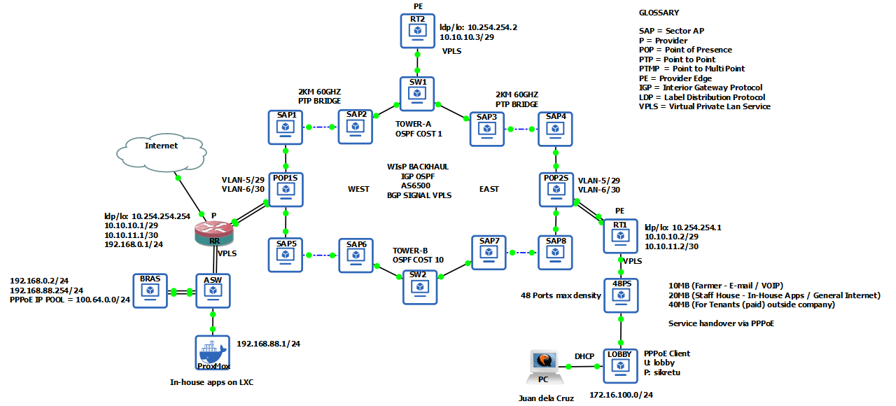

Hi Guys,
Outside of my company this is my first time to do this consultancy of deploying MPLS network outside of my company last week we are live until this day they are working fine, all gears is Mikrotik except for the sector AP, In terms of configuration I think I cover most of the recommended tweak like L2MTU/L3MTU and LDP/OSPF timer synchronization and advertise filter on the loopback subnet and I use ROS v6 as route reflector because of the bug in v7 I attach the actual GNS3 simulation for your perusal and guidance
My question or concerns are as follows (on top of my head)
Since i’m a one man team and I don’t have enough experience with mimosa (i think that was the brand) of the sector AP any gotchas/tweaks? I don’t have administrative control over it but I can get one if I need to.
This is my first time outside of the labs deploying MPLS with Mikrotik but not MPLS in general I do have extensive experience with Juniper, any pointers or to watch out for in mikrotik side of things as far as the MPLS/LDP et. al is concern? I had been told that the network will grow mostly it’s for their consumption (client) but they are looking for the possibility to commercial it outside the company, therefore stability is a greater concern here at least on my perspective not that much of the throughput
Any recommendation / suggestion are welcome I don’t have much question at the moment to be honest, for you guys out there that are doing this for living with Tiks any insight please?

EDIT: I forgot to mention the all mikrotik router is CCR1036 and switch is CRS326 and reasonable throughput is expected is around 700MB in perfect condition in rainy days that’s what we have to find out and the client accept that facts VS no connection at all in the farm :slight_smile:
