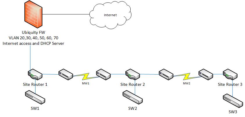

I have recently deployed an MPLS network using RB2011L’s and for the switch’s CSS326’s. This network is setup to connect multiple remote communications sites via Microwave. I have 6 different VLAN’s, each network needs to be isolated as they each carry information serving different agencies/customers. Only Vlan 30 and 40 have active DHCP as they are the only networks I really want touching the internet automatically for end devices.
I have included the config files for a couple of my routers, the switches are setup to have 1 trunk port and then the rest are partitioned out to the different vlans. Outside site 1, I am not able to get access to web pages, I can ping dns servers just fine, just can actually get to any web site. The main Ubiquity firewall serves also as the VLAN internet pipes and DHCP server via a trunk line hooked to the Site1 switch. Again at site 1 everything is great, but once is goes over the MPLS/VPLS pipe things start to fail.

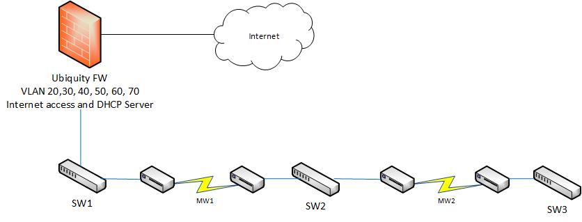

I am looking at my Microwave links as well to see if they are an issue, but my old network that was just switches connected at each end passed internet just fine. Included diagram of old and new network.
