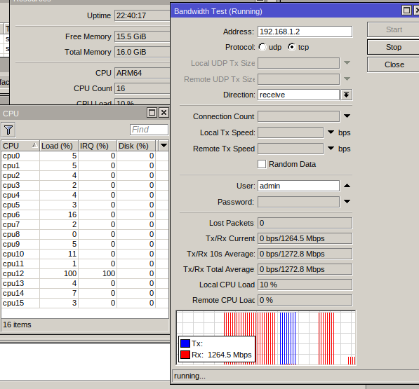

It appears that ROSv7 on ARM/ARM64 locks MPLS decapsulation to cpu0, resulting in a major bottleneck for MPLS/VPLS networks using ARM64 routers such as the CCR2004 and CCR2116.
For example, on our network, we have CCR2004s as our core and site routers. When a device connected to a site router uploads traffic, throughput caps around 500-700 Mbps, cpu0 of the core router hits 95%+, and significant packet loss occurs. Download traffic is mostly unaffected by this issue.

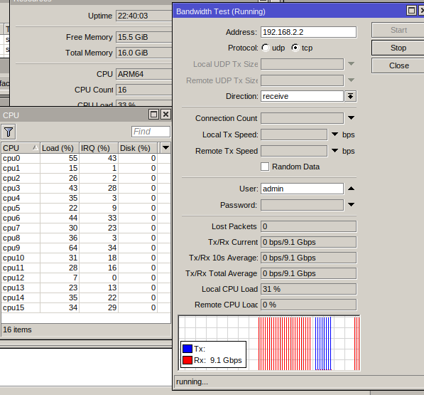

As a temporary workaround, we have overlaid VXLAN, which is correctly multi-threaded on ROSv7 for ARM/ARM64. However, fixing the MPLS/VPLS issue on ROSv7 for ARM64 would be ideal given all of MikroTik’s flagship routers are ARM64.

90% to 100% on one core while the rest is 30% on CCR2116

MikroTik support asked me to try v7.14.1 to see if it resolved the VPLS issues. Unfortunately, it did not. 1200 Mbps is the most I can push between two CCR2116s. On the plus side, VXLAN is doing great, moving over 9Gbps between two CCR2116s. VXLAN seems to be the best bandaid solution for now until Mikrotik can implement multi-threaded MPLS/VPLS encap/decap. :confused:

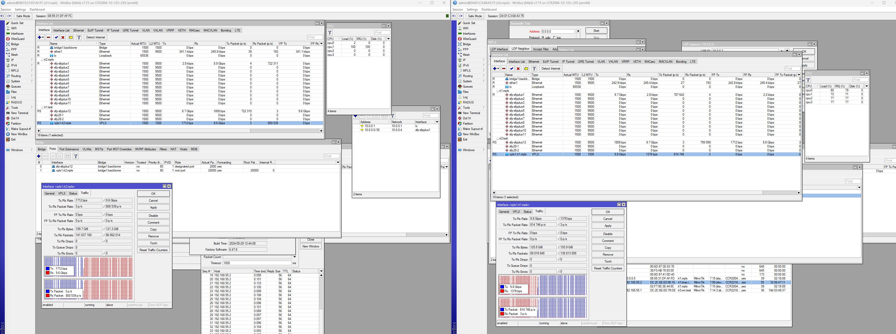

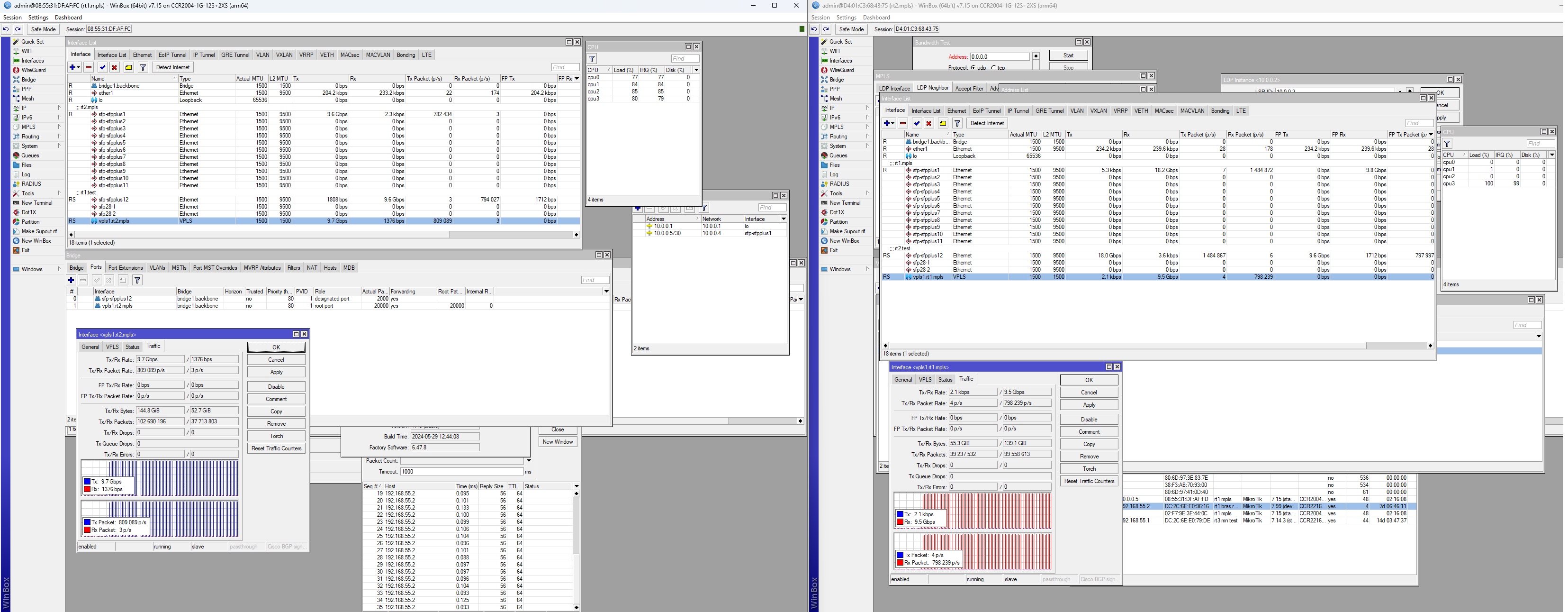

I just tested it myself:
rt1.test (CCR2216)–10G–rt1.mpls(CCR2004)—10G–rt2.mpls(CCR2004)—10G–rt2.test(CCR2216)
vpls tunnel between rt1.mpls and rt2.mpls in a bridge towards the test system. That looks good to me.
I just hope that in version 7.16 MPLS will work again in HW at least on the level of ROS6
thanks,
glueck
So , what I’m seeing here is CCR2004 as PE devices on each end, one CPU thread maxing out on encapsulation, and seems to be balanced CPU on decapsulation.
Is that right??
Even with the single thread you are still getting >9Gbps of throughput. ROS7.15
This setup doesn’t suffer from the bottlenecks that others are reporting earlier in the thread.

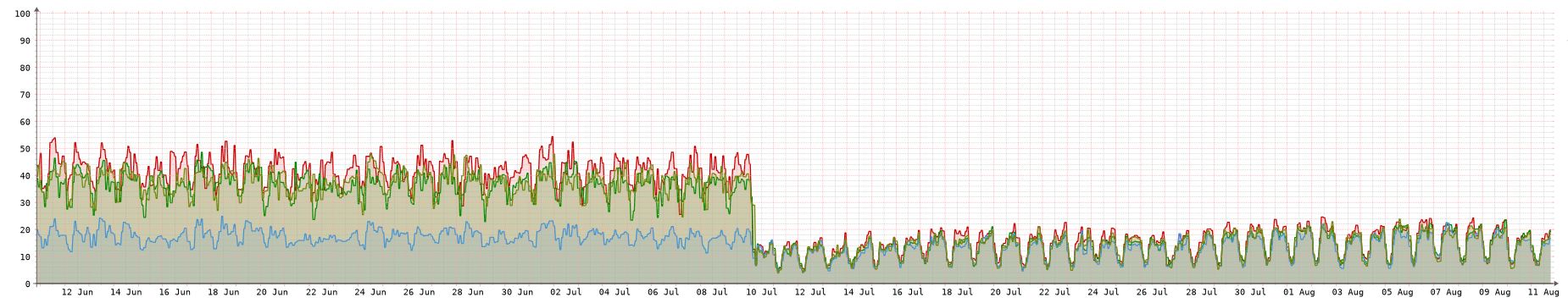

I have BGP router ccr2004 hw and 7.12 → 7.15.2 made big improvement →
