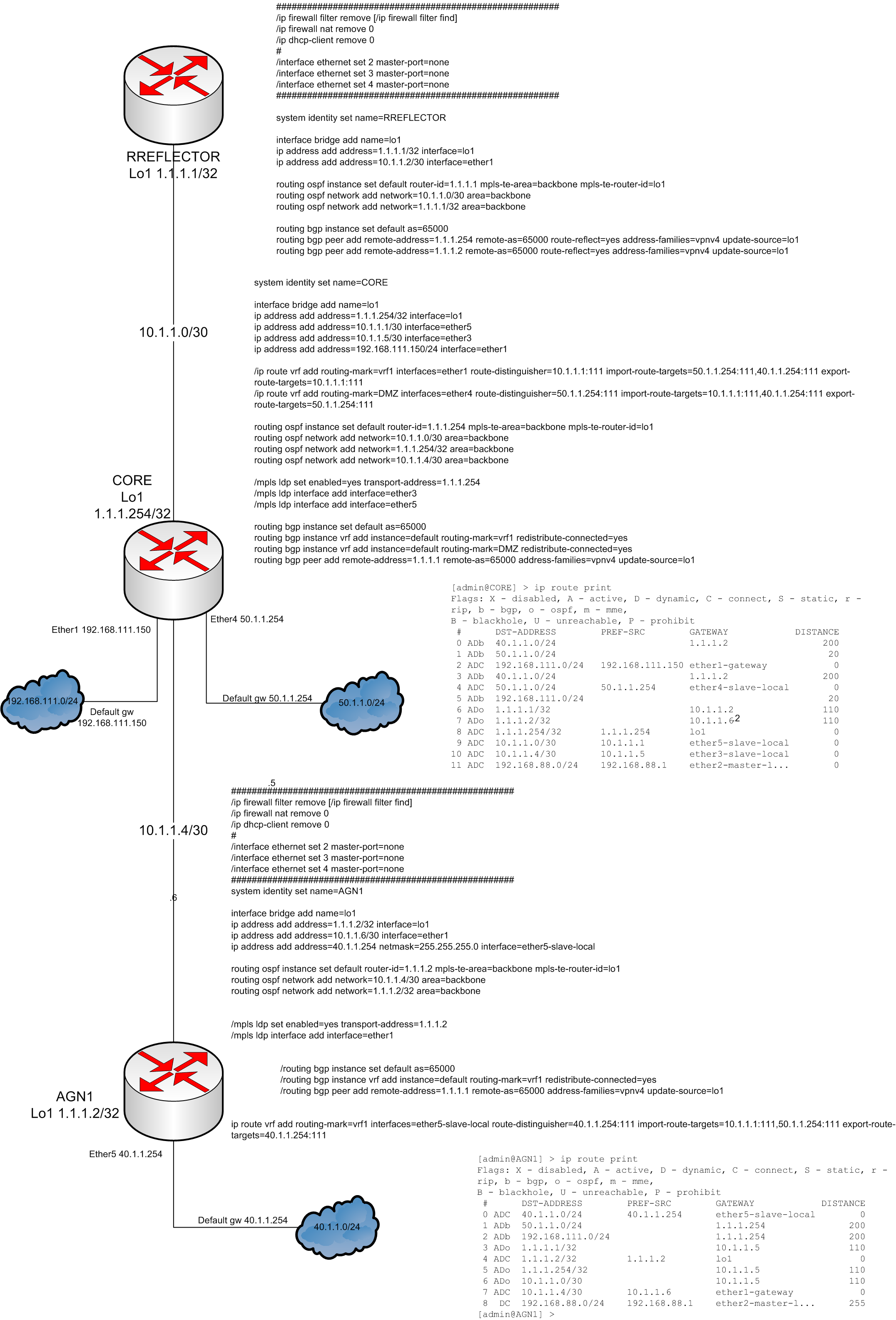

Hello guys , Here im trying to set up an mpls backbone using bgp and route reflector to distribute the reachable subnets.
Route reflector is not in line with user traffic.
There are three main subnets to be interconected: 192.168.111.0/24 , 50.1.1.0/24 and 40.1.1.0/24.
So far I can ping between 192.168.111.0/24 and 50.1.1.0/24 wich are connected to CORE router but can NOT ping to or from 40.1.1.0/24 subnet wich is connected to AGN1 router.
Is there something related to AGN being not directly connected with Route Reflector ? ???
Any help would be great.
btw … When trying to ping from 40.1.1.X to 192.168.111.X or 50.1.1.X Im gettin “net unreachable” eventhough I can see subnets publicated on each router as bellow.
Regards,
Leandro.
Configuration is ok , after upgrading all routers it worked!!
Regards.
