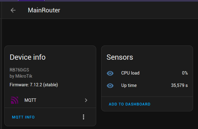

A simple couple of scripts to send router status data to Home Assistant using MQTT.
First script uses the “auto discovery” feature of Home Assistant to configure the device.
It can be executed by scheduler at startup with interval 00:00:00 (so only once).
#config
:local broker "homeassistant"
:local topic "homeassistant/sensor/mikrotik_"
#gather info
:local model [/system routerboard get value-name=model]
:local name [/system identity get value-name=name]
:local board [/system resource get value-name=board-name]
:local version [/system resource get value-name=version]
:local serial [/system/routerboard get serial-number]
#compose message in JSON - CPU load
:local message  "{\"device\": {\"mf\": \"MikroTik\", \"identifiers\": \"MT-$serial\", \"model\": \"$model\", \"sw\": \"$version\", \"name\": \"$name\"}, \"unique_id\": \"MT-$serial-cpuload\", \"state_topic\": \"$topic$name/cpuload\", \"unit_of_measurement\": \"%\", \"state_class\": \"measurement\", \"name\": \"CPU load\"}"
:put $message
/iot mqtt publish broker=$broker topic="$topic$name/cpuload/config" message=$message retain=yes
/log/info message=$message
#Up time - \"board\": \"$board\",
:local message  "{\"device\": {\"mf\": \"MikroTik\", \"identifiers\": \"MT-$serial\", \"model\": \"$model\", \"sw\": \"$version\", \"name\": \"$name\"}, \"unique_id\": \"MT-$serial-uptime\", \"state_topic\": \"$topic$name/uptime\", \"unit_of_measurement\": \"s\", \"state_class\": \"total\", \"name\": \"Up time\"}"
:put $message
/iot mqtt publish broker=$broker topic="$topic$name/uptime/config" message=$message retain=yes
The second script sends the data (only cpu load and up time). It can be runned by scheduler with an interval of some minutes.
#config
#gather info
:local cpuLoad [/system resource get cpu-load]
:local upTime [:tonum [/system resource get uptime]]
#CPU load
:local message  "$cpuLoad"
:put $message
/iot mqtt publish broker=$broker topic="$topic$name/cpuload" message=$message retain=no
#Up time
:local message2 "$upTime"
:put $message2
/iot mqtt publish broker=$broker topic="$topic$name/uptime" message=$message2 retain=no
/log/info message=$message2
Adding more data is trivial and more complex script exists but I wanted to share something simple and good for learning.

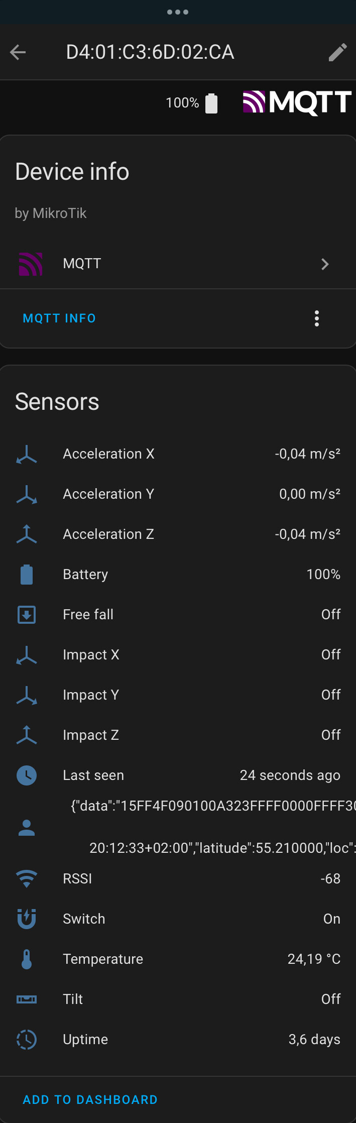

@niklaswelin I have something working now with Home Assistant auto discovery and decoding of the payload server side through Jinja templates. There is a lot missing though in terms of logic to keep the MQTT traffic reasonable. The current implementation is pretty brute force. Anyway, an appetizer:
As it can be seen something is wrong with the device tracker entity. I will see if I can get it packaged into something I feel comfortable sharing :slight_smile:
