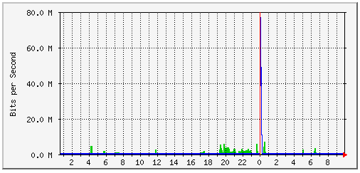

I am attempting to graph simple queues with MRTG, but the outgoing interface graph shows a spike at the start of each 24 hour period. This makes the graph hard to read, because of changes the scale. I’m not sure where this is coming from or how to mitigate it. I’ve tried using different SNMP version, but the spike remains. I suspect there is a counter rolling/resetting that is causing this. Does anyone know what this might be?

Attached is a picture of the graph.

Well, this thread can be discarded (delete doesn’t work here). Turns out my counters were resetting at 12:01am every day, but it was my own doing. I had an old script running data collection on the router. MRTG is graphing the interfaces just fine.
