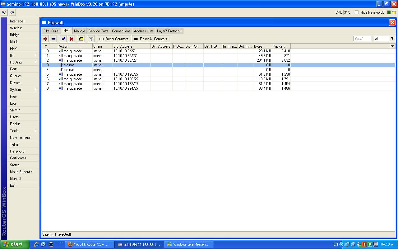

[admin@DS new] /ip firewall nat> print
0 chain=srcnat action=masquerade src-address=10.10.10.0/27
1 chain=srcnat action=masquerade src-address=10.10.10.32/27
2 chain=srcnat action=masquerade src-address=10.10.10.96/27
3 chain=srcnat action=masquerade src-address=10.10.10.64/27
4 chain=srcnat action=masquerade src-address=10.10.10.128/27
5 chain=srcnat action=masquerade src-address=10.10.10.160/27
6 chain=srcnat action=masquerade src-address=10.10.10.192/27
7 chain=srcnat action=masquerade src-address=10.10.10.224/27
plz send me steps for srcnat/masquerade
You really should use the routing-marks to do the src-nat. I’ll give you an example, but I can’t see the ips assigned to your Real8 interface, so if the ip is not 192.168.1.150, replace with the correct ip. Must be the same subnet as the GroupA gateway. The rest GroupX’s should be about the same.
add chain=srcnat action=src-nat routing-mark=GroupA to-addresses=192.168.1.150
Then remove all the masquerades.
You will probably want to add a default srcnat for the default route also.
3 chain=srcnat action=src-nat to-addresses=192.168.23.150
routing-mark=Group D
4 chain=srcnat action=src-nat to-addresses=192.168.34.150
5 chain=srcnat action=masquerade src-address=10.10.10.128/27
6 chain=srcnat action=masquerade src-address=10.10.10.160/27
7 chain=srcnat action=masquerade src-address=10.10.10.192/27
8 chain=srcnat action=masquerade src-address=10.10.10.224/27

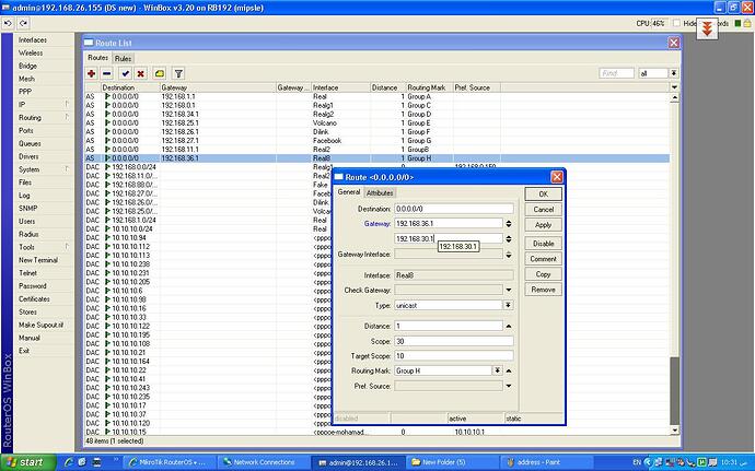

[admin@DS new] /ip route> print
Flags: X - disabled, A - active, D - dynamic, C - connect, S - static, r - rip, b - bgp, o - ospf, m - mme, B - blackhole, U - unreachable, P - prohibit
DST-ADDRESS PREF-SRC GATEWAY-STATE GATEWAY DISTANCE INTERFACE
0 A S 0.0.0.0/0 reachable 192.168.0.1 1 Realg1
1 A S 0.0.0.0/0 reachable 192.168.25.1 1 Volcano
2 A S 0.0.0.0/0 reachable 192.168.1.1 1 Real
3 A S 0.0.0.0/0 reachable 192.168.34.1 1 Realg2
reachable 192.168.23.1 Realg2
4 A S 0.0.0.0/0 reachable 192.168.26.1 1 Dilink
5 A S 0.0.0.0/0 reachable 192.168.27.1 1 Facebook
6 A S 0.0.0.0/0 reachable 192.168.11.1 1 Real2
7 A S 0.0.0.0/0 reachable 192.168.36.1 1 Real8
8 ADC 10.10.10.0/24 10.10.10.1 0 Real
plz look packets=0

I will be more specific about why no packets. That routing-mark (GroupD) srcnat is never evaulated. The order in this list is important. The NAT routine finds the 10.10.10.32/27 masquerade rule first, and that is it. It never goes any farther down the list to get to the src-nat rules.

It looks like the route is there already. Does it have a routing mark?
/ip route print detail
If it does not have a routing-mark, add the gateway entry above with the routing-mark.
The srcnat you must move. It will be added at the bottom of the list.
ADD: It appears you entered that default route as a load balancing gateway, like maybe
add gateway=192.168.34.1,192.168.23.1
If so, add each gateway separately with its own routing-mark, then remove the old one.

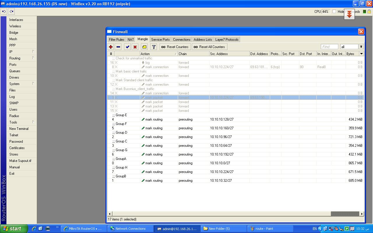

will u plz send me deitails : Route,Nat and Mangle rules
mant thxx,
All this is based on your mangle rules. I don’t know what your goal is. I was trying to get the setup you selected working.
I have given you the nat rules already, all based on the routing-marks you had entered in “/ip route”. If you are going to use routing marks, you should use them on the gateway (/ip route) and the srcnat (/ip firewall nat). This setup allows you to simply change a routing mark assignment, and everything follows along. No need to modify the routes or srcnats.

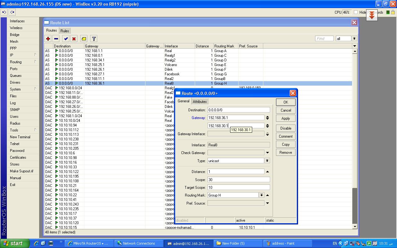

These are the correct entries for these routes. Enter these, then remove the rule currently #3.
add gateway=192.168.23.1 routing-mark=GroupJ
add gateway 192.168.34.1 routing-mark=GroupD
