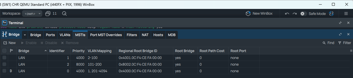

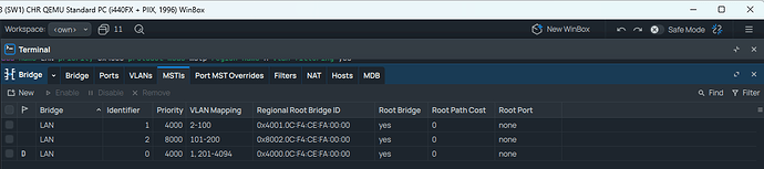

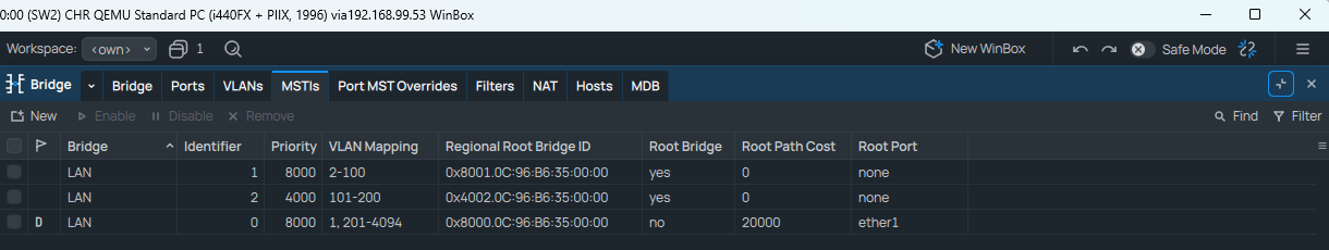

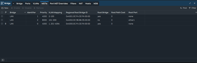

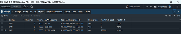

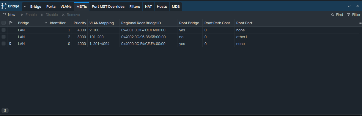

Today we are planning to change one of our PoP spanning tree from RSTP to MSTP and before we do that I made sure that I need to lab this first to prevent surprises on the actual equipment, this is the first time i’m going to do this because there’s no rapid pvst+ in MT I hope someone could lend their set of pair of eyes again on this please.
The issue is on vlan 2-100 i make it sure that SW1 should be the root bridge while vlan 101-200 should be a secondary root bridge and in the other switch it should be reverse
Now the question is why both switches claim they are both root bridge for vlan 2-100 it was supposed to be the SW1 is the root bridge while SW2 in the other hand it’s not supposed to be the root bridge

I think i got it now, the region name and revision no must be the same :slight_smile: that’s the issue

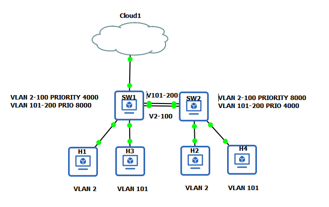

The initial work/scope there is to setup a brand new stack consist of 8 mikrotik switches and since there’s no rapid pvst+ in MT which the customer preferred so i was being instructed to implement MSTP though I don’t have experience with it, I’m happy to obliged because this is work and another great learning experience.
To your question why MSTP because in RSTP or spanning tree for that matter one of the port will be blocked and not forwarding traffic until one of the port dies for it to transition from blocking state to forwarding to prevent loop and for the customer they want to maximized all of its bonded ports, this is a big PoP serving a sizable customers and my problem only start when they decided to merge this with another stack with Juniper which will happen a week from now.
What you see in the diagram it’s just for illustration purpose of my issue/inexperience but not depict the real picture of the setup and the customer is very brave because MSTP + 802.3ad was just recently been fixed.
