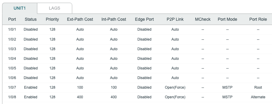

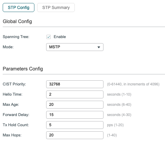

I would like request some advice on the config setting for STP between TPlink (T2600G-28TS) to RB960PGS, the TP-link uses port7 as master and port8 as backup,
So I would like have
TPlink port 7 to port 1 of RB960 ( master STP active )
TPlink port 8 to port 2 of RB960 ( backup )
What I am a little confused about is the bridge/port/stp setting - Priority, Path Cost, Internal path cost, also Auto Isolate, Restricted Role, Restricted TCN, BPDU Guard
