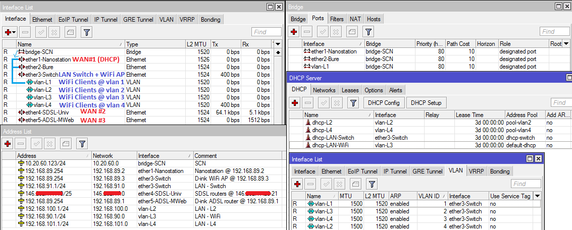

I have 4 tagged VLAN’s on ether3-Switch, of which only 1 (vlan-L1) is bridged with 2x untagged Ethernet ports (ether1-Nanostation & ether2-Bure).
The untagged ether3-Switch works for managing the D-Link AP, as well as for all the PC’s connected to it via an unmanaged (I think it’s an Accton) 24-port 100Mbps switch.
I have attached a WinBox screenshot of this too:

    interface=ether2-Bure path-cost=10 point-to-point=auto priority=0x80
add bridge=bridge-SCN disabled=no edge=auto external-fdb=auto horizon=none \
    interface=ether1-Nanostation path-cost=10 point-to-point=auto priority=\
    0x80
    interface=vlan-L1 path-cost=10 point-to-point=auto priority=0x80
/interface bridge settings
set use-ip-firewall=yes use-ip-firewall-for-pppoe=yes \
    use-ip-firewall-for-vlan=yes
/interface vlan
add arp=enabled disabled=no interface=ether3-Switch l2mtu=1520 mtu=1500 name=\
    vlan-L3 use-service-tag=no vlan-id=2
    vlan-L1 use-service-tag=no vlan-id=1
    vlan-L2 use-service-tag=no vlan-id=4
    vlan-L4 use-service-tag=no vlan-id=3
add address-pool=default-dhcp authoritative=after-2sec-delay bootp-support=\
    static disabled=no interface=vlan-L3 lease-time=3d name=dhcp-LAN-WiFi
add address-pool=dhcp-switch authoritative=after-2sec-delay bootp-support=\
    static disabled=no interface=ether3-Switch lease-time=3d name=\
    dhcp-LAN-Switch
add address-pool=pool-vlan2 authoritative=after-2sec-delay bootp-support=\
    static disabled=no interface=vlan-L2 lease-time=3d name=dhcp-L2
add address-pool=pool-vlan4 authoritative=after-2sec-delay bootp-support=\
    static disabled=no interface=vlan-L4 lease-time=3d name=dhcp-L4
add address=192.168.90.0/24 comment="LAN - WiFi" dns-server=192.168.90.1 \
    domain=tuis gateway=192.168.90.1
add address=192.168.91.0/24 comment="LAN - Switch" dns-server=192.168.91.1 \
    domain=tuis gateway=192.168.91.1
add address=192.168.100.0/24 comment=VLAN-L2 dns-server=192.168.100.1 domain=\
    tuis gateway=192.168.100.1
add address=192.168.101.0/24 comment=VLAN-L4 dns-server=192.168.101.1 domain=\
    tuis gateway=192.168.101.1
add address=192.168.90.1/24 comment="LAN - WiFi" disabled=no interface=\
    vlan-L3 network=192.168.90.0
add address=10.20.60.123/24 comment=SCN disabled=no interface=bridge-SCN \
    network=10.20.60.0
add address=192.168.89.254/32 comment="Nanostation @ 192.168.89.2" disabled=\
    no interface=ether1-Nanostation network=192.168.89.2
add address=146.xx.xx.xx/25 comment="SDSL routers @ 146.xx.xx.xx-xx" \
    disabled=no interface=ether4-SDSL-Univ network=146.xx.xx.0
add address=192.168.89.254/32 comment="D-ink ADSL router @ 192.168.89.1" \
    disabled=no interface=ether5-ADSL-MWeb network=192.168.89.1
add address=192.168.89.254/32 comment="D-ink WiFi AP @ 192.168.89.3" \
    disabled=no interface=ether3-Switch network=192.168.89.3
add address=192.168.91.1/24 comment="LAN - Switch" disabled=no interface=\
    ether3-Switch network=192.168.91.0
add address=192.168.0.101/24 disabled=yes interface=vlan-L3 network=\
    192.168.0.0
add address=192.168.100.1/24 comment="LAN - L2" disabled=no interface=vlan-L2 \
    network=192.168.100.0
add address=192.168.101.1/24 comment="LAN - L4" disabled=no interface=vlan-L4 \
    network=192.168.101.0
@reverged
I’m assuming the problem comes from loops being caused in the network if you do not have some sort of filter to prevent traffic entering from one VLAN leaving another. It may not be a noticeable issue with a very small amount of VLANs, but it certainly is a problem if you have several VLANs sharing the same interface all bridged together. Also without some form of filter, either with the horizon option or a bridge filter, you are basically removing the purpose of the VLANs and keeping traffic separate.
It’s not always possible to run multiple interfaces to keep traffic separate, that’s where VLANs come in. VLANs are primarily a way to have the same hardware set up multiple logical layer2 networks without the need to buy extra hardware. I use them to keep clients isolated from each other and for troubleshooting. On many of my networks, I can tell you what device someone is connected to just by seeing what VLAN they are coming off of. This saves me a lot of time in troubleshooting as I don’t need to hunt them down on the network.
@Pada both the 750 and 750G have a switch chip, and I believe they are enabled by default with ether2-5 on the switch group. You can make each Ethernet interface it’s own routed interface by removing them from the switch chip. Those models just have a different switch chip from each other.
http://wiki.mikrotik.com/wiki/Manual:Switch_Chip_Features
