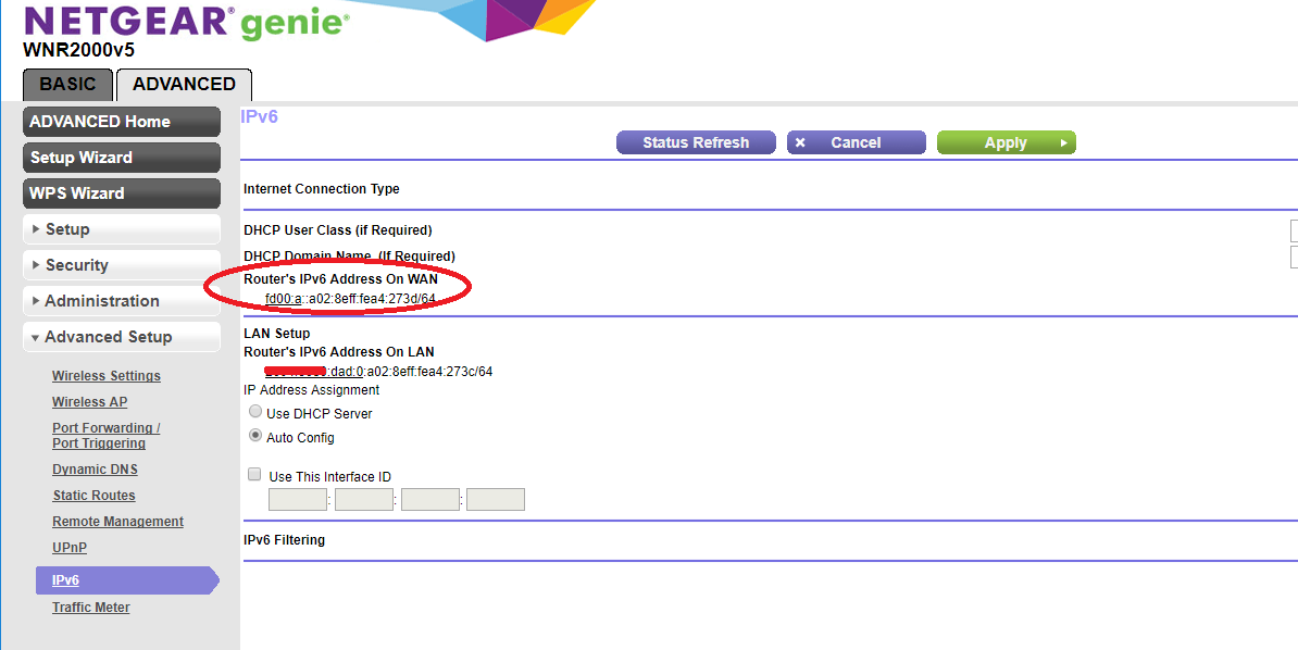

Since I posted last, this configuration fixes both the netgear and the linksys routers. With nothing but a linklocal on my dhcp MT router they do not work. Per your suggestion I changed the customer facing router IP to fd00:a::/64 and it still works. So it doesn’t appear to matter what IP is there as long as it’s something.

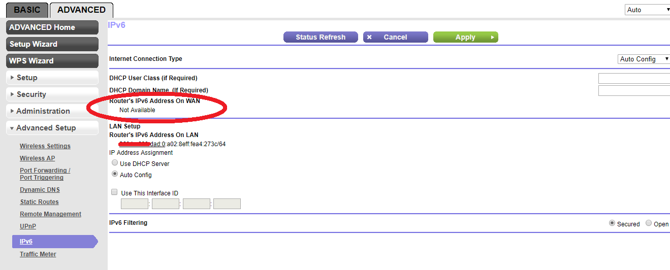

Heres 2 screen shots of the netgear router, the one with link local only gets no wan ip, then when I add an IP facing that router, it matches it and all works.
