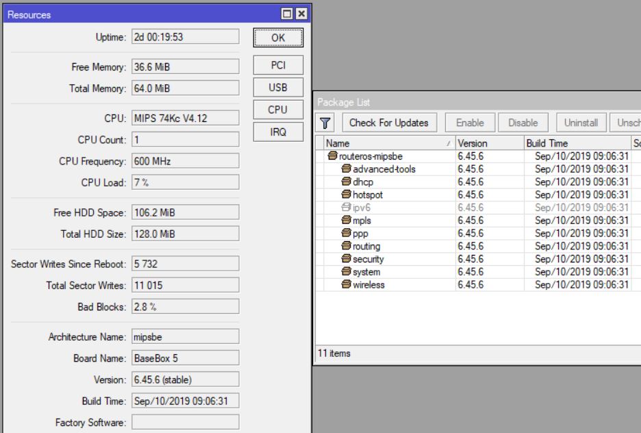

Probably is a problem with NAND memory. Check the bad blocks percentage on System → Resources.
Also check if installation is ok on System → Packages
I had this problem with a BaseBox 2 but it solves “magically” when I do a big update (6.42.5 to 6.44 with firmware included) I not know why this happened, but Bad Block downs to 0.0% and no more bricks on the device.

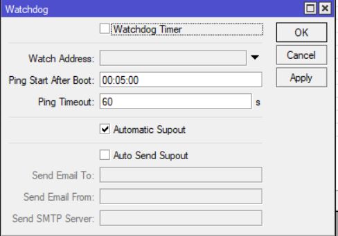

When you say its beeping, it does that in a loop? Like restarting again and again?
If yes, maybe you ve set an IP address in watchdog?
As you can see, you have 2,8% of bad blocks. In my case I had 2,6%.
Regards.

Yes there was watchdog, but I already turned it off. I also changed the AC-contact that was behind the UPS. Now UPS is isolate.
And I am waiting.
You ve turned watchdog off, However the IP address textbox is emty or not ?
The ip address box with the watchdog enable/disable button are different features…
Your device is just in a restart loop!
