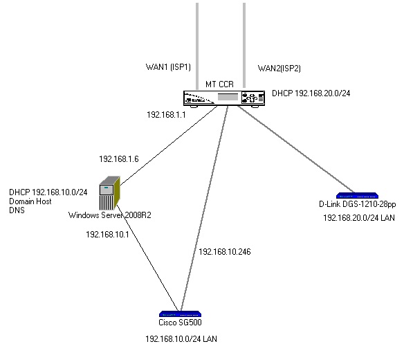

Hi, i have unusual problem with connection.
In Attached picture You can see.
I have problem to reach 192.168.10.X from 192.168.20.X without connected 192.168.10.246 Link
But from 192.168.10.X i can reach 192.168.20.X without 246 link
How to set M$2008R2 serv properly ? Anyone have similar problem?
I have computer in 192.168.10.X i can ping 192.168.20.X but when i have computer in 192.168.20.X i can’t ping 192.168.10.X
but when i connect 192.168.246 to MT i can reach from 192.168.20.X with no problem
But from 192.168.10.X i can reach 192.168.20.X ewen without 246 link

I’m trying to route two subnets, one behind mikrotik the second one behind M$Server2008R2
post an export.
Does the mikrotik router has an 192.168.10.x/24 ip address assigned?
Neski
August 14, 2017, 10:11am
5
nope

Then you need to assign one, eg 192.168.10.254/24 on ether interface facing SG500. Any host having just one connection in the 192.168.10.x/24 range will need 192.168.10.254 as default gateway, so you’ll need to modify DHCP Server at 192.168.10.1 to hand out 192.168.10.254 as gateway.

pukkita:
WinSvr2008R2 and Mikrotik are Router’s.
Mikrotik connection to WinSvr2008R2 is WAN connection for M$Srv.(192.168.1.6)
Link - 192.168.10.246 is a something what we want to remove.
How to fully route Mikrotik with M$Svr2008R2?

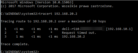

pukkita:
Without connection from SG500 to Mikrotik i have something like this picture.. idk why
I don’t know either, where is 192.168.20.2 supposed to be?
I am afraid you need to do some cleanup.
Cannot understand either why the need of the M$ routing at all, you’d better have one single router to act as default gateway for all the network, it will simplify management and avoid routing loops.
For that same reason, optimal DHCP server placement will be the mikrotik.
We bought mikrotik 2-1 month ago and we prepare to cleanup.
192.168.20.2 supposed to be connected to D-Link switch
We afraid a little to remove routing from M$ cause we don’t have spare domain controller and we don’t know how to M$ behave after remove routing and second networkcard ..
In that case:
1.- Connect M$ 192.168.10.1 ethernet card to a Mikrotik ether port, say etherX
2.- Create a bridge, and add: etherX and the mikrotik ether port being connected to Cisco SG500
3.- Assign 192.168.10.254/24 to that bridge
4.- Modify DHCP server as I specified on previous post regarding DHCP (setting 192.168.10.254 as default gateway).
Doing this all PCs will be able to reach all subnets, as long as the proper gateway is set on them depending on subnet , e.g. if 192.168.20.1, 192.168.1.1 and 192.168.10.254 are assigned on Mikrotik router:
All Devices (PCs or L3 switches) on 192.168.1.0/24 subnet should have 192.168.1.1 as default gateway
All Devices (PCs or L3 switches) on 192.168.10.0/24 subnet should have 192.168.10.254 as default gateway
All Devices (PCs or L3 switches) on 192.168.20.0/24 subnet should have 192.168.20.1 as default gateway
Doing this all PCs will be able to reach all subnets, as long as the proper gateway is set on them depending on subnet, e.g. if 192.168.20.1, 192.168.1.1 and 192.168.10.254 are assigned on Mikrotik router:
So You suggest to connect M$ server with two phisical interfaces? Connect from MT->M$ as 192.168.1.6 and from 192.168.10.1 (M$) → MT ?
M$Svr is getting internet from MT interface 192.168.1.6
pukkita
August 14, 2017, 12:46pm
13
Yes. You don’t want to disable them, isn’t it?
After doing it, you can test by disabling one of the interfaces, more specifically the one with 192.168.1.x/24 addressing, as I assume LAN PCs are in the 192.168.10.x range.
As long as you set the default gateway on M$ as 192.168.10.254 M$ will reach Internet fine. Watch out for any firewall rules.
