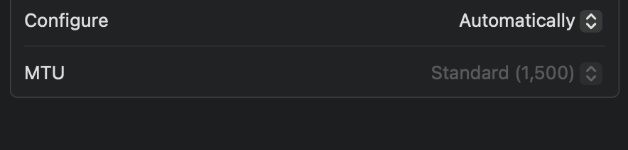

And another mystery on Mac, it does’t allow me to set manual MTU over 1436, but when it is on automatic it is set to 1500
On the PC you’re seeing the overhead of ping, why it’s 1480. I think Mikrotik take the icmp overhead into account when you input a desired packet size (“Packet size to be used in bytes (includes payload and IP header)”).
Ah, didn’t know that, ok so 1500 is actually correct MTU. Thx
