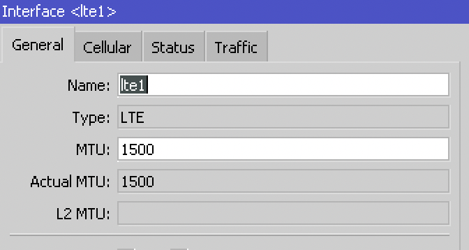

LTE interface on MT:
Log:
lte,info lte1 mbim: network advertises lower mtu: 1358
lte,info lte1 IPv4: xxx.xxx.xxx.xxx, DNS: xxx.xxx.xxx.xxx,xxx.xxx.xxx.xxx, MTU: 1358

Same report from speedguide.net, but no longer in log
when connected.
Actually connection log also differs:
no longer MTU value
Is this means that ROS sets MTU for LTE interface when it is differently advertized, but Actual MTU is not updated?
I think the “Actual MTU” is from RouterOS’s point-of-view so it matches the MTU you set - not related to the “network MTU”.
The log message does go away if it matches.
Whether the message is right…different question, and likely depend on your specific LTE carrier… In my cases, the value in the log does match US and different APN certainly produce different value even on the same carrier. But the do seem to be “correct”
e.g. BOTH a ping test and the SpeedGuide site match the “network advertises [lower/higher] mtu” in all cases I’ve seen.
