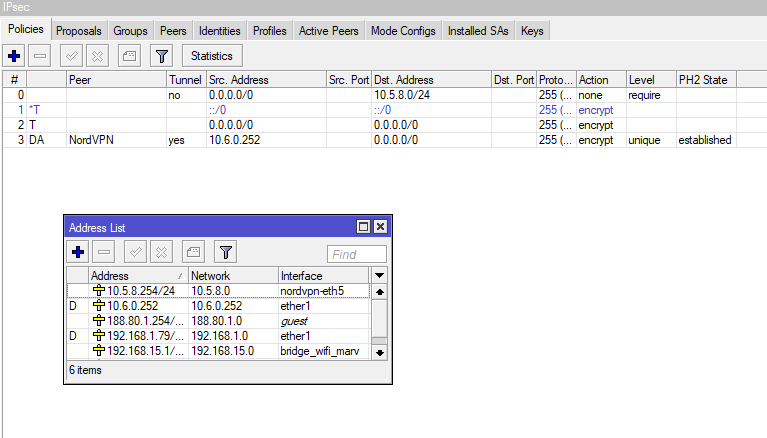

Also, you have two LAN subnets, 192.168.0.0/24 for local devices and 10.5.50.0/24 for hotspot clients. So if it’s the hotspot clients who experience this problem, you need a similar action=none policy also for that subnet.
I wrote underneath the default and not underneath the NordVPN line(s) assuming ofcourse the default template (*T) is at position 0.
It is a manually created template so putting it at postion 0 is on the table again?
Edit: moving the default to position 0 can be done by the command:
move *ffffff destination=0

Disable fasttrack up-to use IPSEC policy and create a static policy handling the packets also not working.
Could you share your full config for NordVPN?
I use the provided config by Mikrotik in the Wiki and I use connection-marking to selrct the traffic I want have handled by the VPN. Fasttracking and IPSEC is a no-no.
The policy has to be at the top in /ip ipsec policy table and the NordVPN lines underneath. To be sure the order is correct you could run: /ip ipsec policy print

I'am in the same situation: Devices does get the VPN ip and are able to ping websites but cannot browse the internet:

/ip hotspot profile
/ip ipsec mode-config
add name=NordVPN responder=no src-address-list=local
/ip ipsec policy group
add name=NordVPN
/ip ipsec profile
add name=NordVPN
/ip ipsec peer
add address=nl125.nordvpn.com exchange-mode=ike2 name=NordVPN profile=NordVPN
/ip ipsec proposal
add name=NordVPN pfs-group=none
add name=dhcp_pool0 ranges=10.5.8.10-10.5.8.250
add address-pool=dhcp_pool0 disabled=no interface=ether3 name=dhcp1
add address=10.5.8.254/24 interface=ether3 network=10.5.8.0
/ip dhcp-client
add disabled=no interface=ether1
add address=10.5.8.0/24 dns-server=103.86.96.100,103.86.99.100 gateway=
10.5.8.254
set allow-remote-requests=yes
/ip firewall address-list
add address=10.5.8.0/24 list=local
add action=masquerade chain=srcnat out-interface=ether1
/ip ipsec identity
add auth-method=eap certificate="" eap-methods=eap-mschapv2 generate-policy=
port-strict mode-config=NordVPN password=******* peer=NordVPN
policy-template-group=NordVPN username=@
/ip ipsec policy
add dst-address=0.0.0.0/0 group=NordVPN proposal=NordVPN src-address=
0.0.0.0/0 template=yes
/system clock
set time-zone-name=/**
/system logging
add prefix=vpn topics=ipsec
add action=none dst-address=10.5.8.0/24 src-address=0.0.0.0/0 place-before=0
What can i do?
You are not in the same situation because this topic goes about not being to see the preview in this forum due to problems of ICMP 3/4 packets not being return to the client by the router.
Please open a own topic on this.
Seeing Ether3 but you screen shot says nordvpn-eth5.
Code: Select all
Yeah i change router for another test. The screenshot is for first router but config is same.
i have 13.224.67.118 after the command :put [resolve nu.nl];
The default template will be moved to the top of the list if it was not already there. The second line should above (action=none) should be below default and above any added IKEv2 provider lines.
The explaination by Sindy.
Anyway, there should be a remedy - a static IPsec policy action=none src-address=0.0.0.0/0 dst-address=the.client’s.subnet placed before the policy template which is used to build the dynamic policy with the responder-provided IP address as src-address. This action=none policy will shadow the dynamically generated one so even though the ICMP code 3 type 4 packet will likely get src-nated by the dynamic src-nat rule, it will not reach the dynamic policy (which would divert it into the tunnel) so it will make it to the client. The client won’t care about the source address as it has no relevance for it, so it should adjust the size of the re-sent TCP packet and all the subsequent ones accordingly.
This solved my long standing problem. with that work around and many many thank to Sindy for suggesting this!
