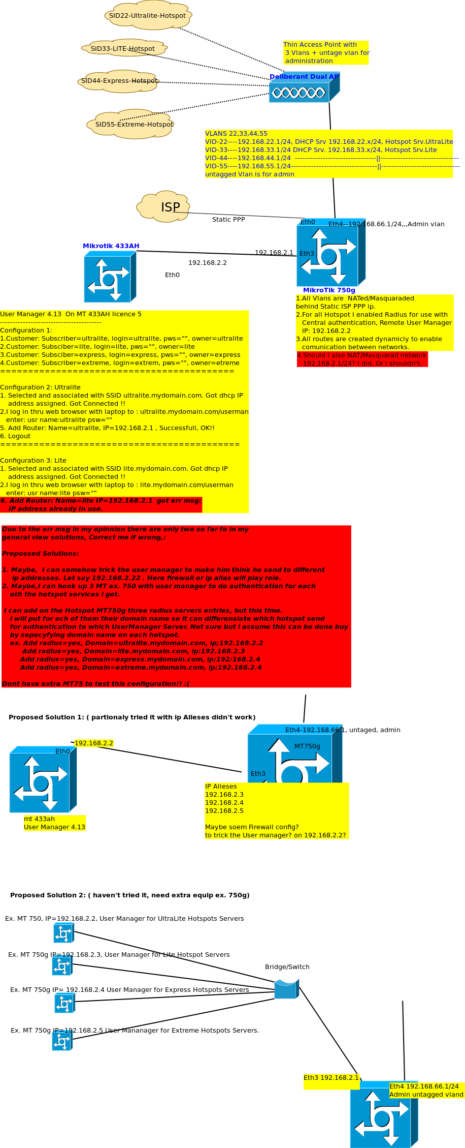

Check my hotspot diagram for better understanding of the problem. Maybe you have done this or know the solution or maybe you can direct me in right way.
My goal in all of this is to have multiple hotspots on one or many APs with different pricing.
I tried to use 1 user manager for all of them on that one AP but no luck. Can only use 1 ip address in user manager. And when adding that one address there is no way what hotspot on that address you want to configure on the user manager
So i created two subscribers. Two subscribers on one MT Device, still the same err msg: “Ip address already in use.”
Can you help?
Don’t know about User Manager as I don’t use it, but this works trivially with different RADIUS domains configured on the Hotspot instances and other RADIUS servers such as FreeRADIUS. Just ensure the password check also evaluates the domain passed on in the ACCESS-REQUEST.
Not particularly helpful if you’re going to use User Manager, but still.
