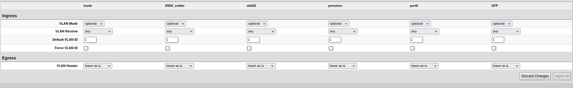

so what is vlan1 used for ?
can i see that as a sort of trunk port, both to the switch (ether9-rb260gs) and the wifi network (ether10-r500) ?
strangest thing is that i can access the switch config page (192.168.0.2) over vlan 1, but not the config pages for the AP (192.168.0.5)
Vlan1 is a background entity used by the bridge and smart devices and should not concern you in any way.
If you are using vlan1 for data, as I stated replace it with a full vlan ( dhcp etc ).
Then repost your config for review if still having issue.s

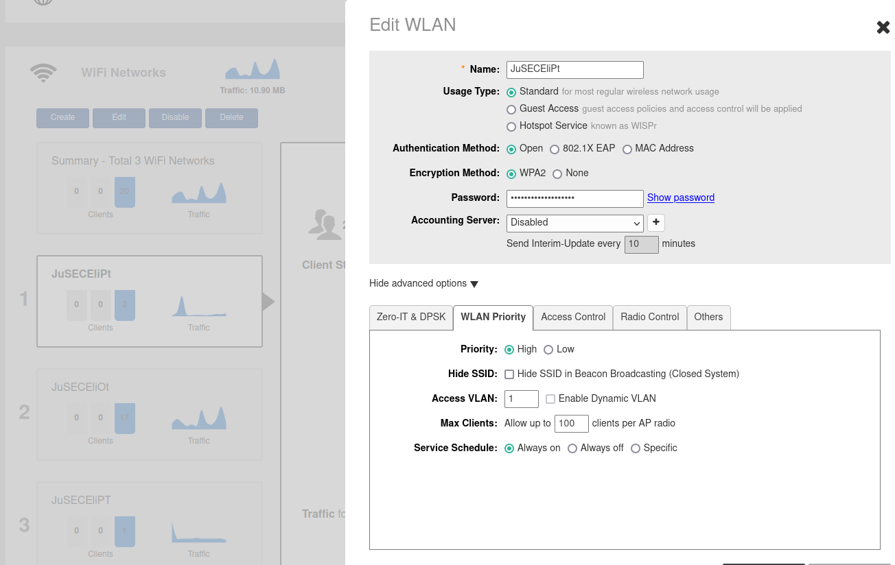

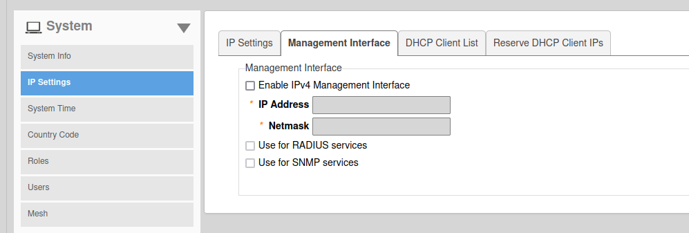

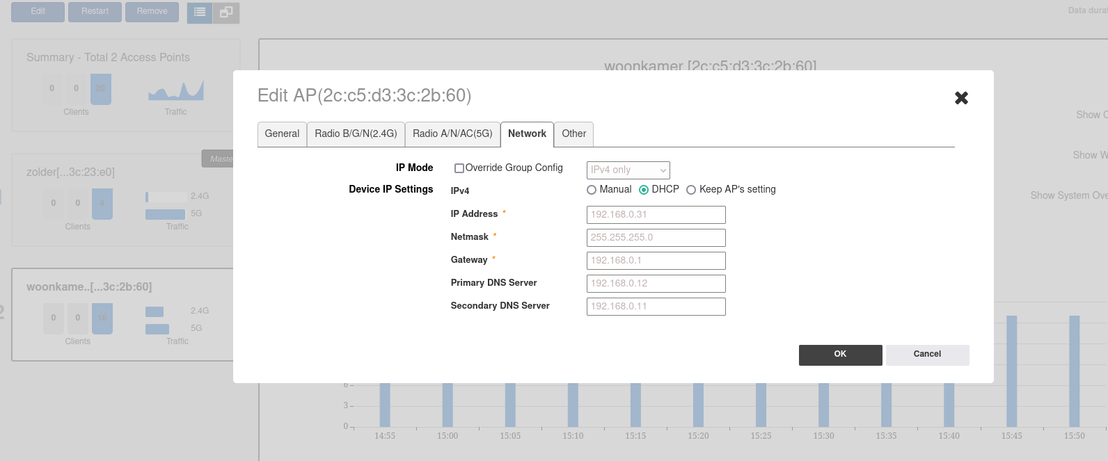

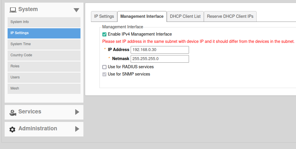

the Ruckus R500 Access Point is not able to have a management VLAN
https://community.ruckuswireless.com/t5/ICX-Switches/Ruckus-Unleashed-VLAN-Setup/m-p/34541
Unleashed does not allow Management IP to be on a VLAN (unlike Zone Director / non-Unleashed version) but it does allow Wifi SSID to be assigned to specific VLANs. So configuration I used was to have a trunk port to the Ruckus AP from the switch. However it needs to be configured so the untagged traffic (from the AP) is tagged to your management VLAN and then the SSID VLANs as members. On Juniper switches this is called native-tagging. Exact configuration depends on your switch vendor.
You can then used Advanced options to define the specific VLAN tags for each SSID network.
There is no option to configure tagging for the AP management traffic within Unleashed
https://www.reddit.com/r/RuckusWiFi/comments/p8gdto/losing_management_access_when_connected_to_trunk/
If you don’t have a management VLAN set on the AP, you just need to set the port on the switch to switchport trunk native vlan 500.
i tried setting the vlan of ether10-r500 to pvid5, but that did not help.

meanwhile, i seem to have difficulties getting the devices on the switch RB260GS (SwitchOS) working with the new vlan5 ?
here’s what i have right now.
R500_zolder is another wifi AccessPoint working as a mesh with the one connected to the RB4011 Router (should provide vlan5, vlan110, vlan120)
ds920 is a Synology NAS which should be accessible from vlan5 and vlan110
proxmox is a the virtualization server, accessible through 192.168.0.20. it has containers running in vlan5, vlan105 and vlan110)
port5 is the actual HP server on which proxmox runs. accessible only on ip 192.168.0.8
the SFP port i don’t use

management ip of the ruckus network
AP interface of one of the access points

what i don’t get is why when mvlan5 is on the router and the pvid of ether10-r500, and vlan5 is the vlan for the wifi network my wireless clients are connecting to the wifi network, but don’t get an ip from the router.

i’ve tried starting with a blank config, just adding the needed vlan99, interfaces, network.
still the same problem.
untagged, the wifi network is accessible, but the management interface is not
tagged is the other way around

as you can see, i don’t have the vlan options in the Management interface screen

Your other option may be to not even use a managment interface.
How else can you assign an IP to the access point?
By default Ruckus bridges the SSID with network on the untagged network and grabs an IP for itself – just like most APs… So if you need only one SSID, just the defaults should be okay and untagged what VLAN you want on the Mikrotik side. If you need multiple SSIDs with different VLANs from Mikrotik, a hybrid port might be an option then (e.g. mgmt untagged, and the SSIDs assigned to the desired VLAN).
i’ve tried both ways.
with and without management interface, dhcp on the access points.

the trouble seems to be in the mgmt vlan assignment. looks like the unleashed console only is accessible when using vlan1 (and i don’t want to use that )
