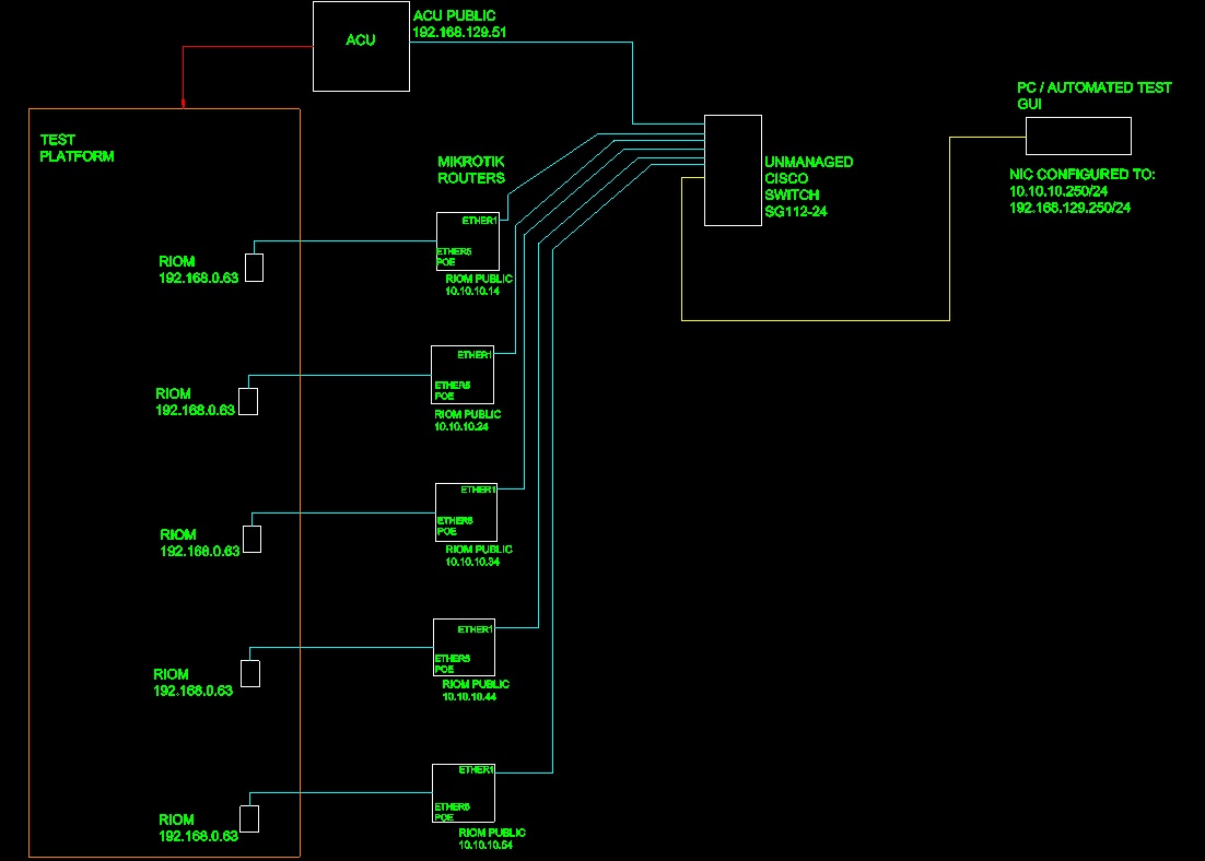

The test fixture
10 RIOMs, each one behind a single Router.
Routers are RB750UPr2 hex poe lite (mipsbe) v6.47.9
(config script below)
Diagram of test set up (below)

I have attached a simple illustration of my test set up (keep in mind I have 10 routers, but this only shows 5).
Seems simple, description and image are fine, I’d expect (for first router):
  • 10.10.10.14/24 on ether1
  • 192.168.0.1/24 on ether5
  • some src/dstnats mappings between 10.10.10.14 and 192.168.0.63
And that’s pretty much it. But posted config seems to be for something slightly different. What’s with all those other addresses? Meaning all 10.10.10.x, 192.168.129.1/24, 192.168.0.x in NAT?

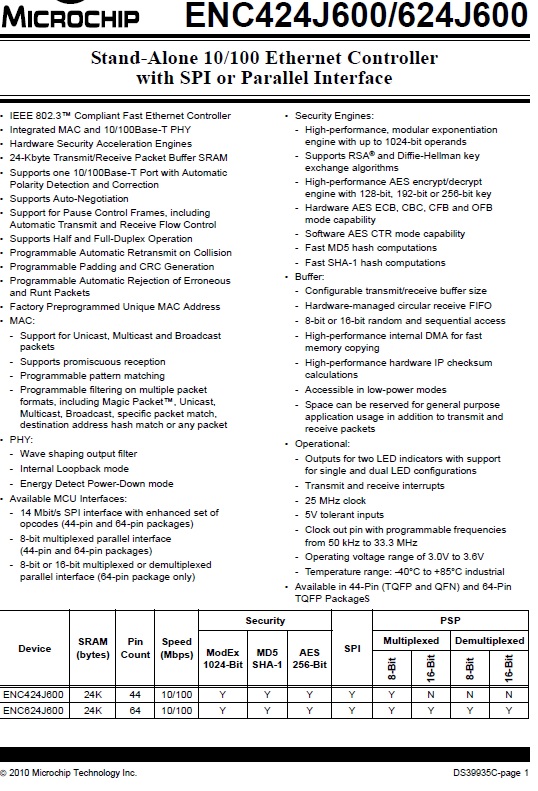

The ethernet controller on the RIOM is a DigiKey Stand Alone 10/100 with SPI or parallel - ENC424J600T-I/ML. I have requested from Engineering the config specs or code, but it’s highly unlikely I will get it. I’ve attached the DigiKey specs page in case any insights can be gleaned.

Yes, all RIOMs are 10/100, and the routers are seeing that. Im very happy with the settings you gave me. Initial testing this evening showed good comms. I still need to run the actual procedure though.

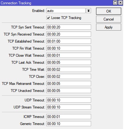

I had problems with connections dropping or being blocked under various use cases within our test GUI, typically during transitions from calibration mode to testing mode, or immediately before beginning a test, where the GUI sends icmp to RIOMS 1-10 before beginnig it’s testing. By shortening some of the connection tracking imeout values, the frequency of problems seemed to be less. Any issues you can see from this?
Is there a preferred way to configure RouterOS connection tracking to be fully open and allow all connections/ports without any restrictions? (as long as they follow my NAT rules)
I know that when it keeps connections in the tracking list, it will prevent “new” ones that match. Can I minimize tracking without totally disabling tracking? I guess, what is the preferred way to still allow tracking without having it block connections?
Image of Current timeouts:

Quick test says that check-gateway=ping uses 10 seconds interval. Using Netwatch should be ok, assuming that RIOM doesn’t have some problem with pings.
Connection tracking has some limits, but if you use any kind of NAT, you can’t get rid of it.
Duplicate ports could be a problem for TCP, where you can see when connection starts. So if old one would be still active, new one using same source port (same everything, source/destination addresses/ports) would fail. But normally it shouldn’t be a problem, because Windows changes source port for each new connection.
UDP wouldn’t mind at all, as it doesn’t have connections, so “duplicate” would be seen as part of what conntrack already knows.
But there could be problem with too low timeouts. If there was a pause without packets, connection would time out and following response from RIOM would be seen as new, and router wouldn’t know that it should change its source to 10.10.10.x. UDP could be fixed with srcnat rule (see my simple config at the beginning). TCP probably not.
Which I do (use NAT), because PC/GUI expects all replies to come from a 10.10.10.X address. And RIOMs all expect everything to come from 192.168.0.X address. So I am stuck having to disguise both internal and external addresses. I did try “netmap” per your original. No dice.
I’ve only been able to get dst-nat to work, and it seems to take care of disguising the reverse path simultaneously.
I did have a src-nat rule under the dst-nat rule, but looking at packet counters, it did not appear to ever get used.
I did see that behavior, but perhaps 10 devices plus many connection “transactions” could be causing ports to get used up? It could be a benign warning, as I was still able to complete my test runs with those errors being intermittent.
What do you mean UDP does not have connections? Would that not mean conntrack does not track them, therefore could not be part of what it “already knows”? Forgive my nit picking. I assumed everything was tracked in some way.
I predicted this, and did have a firewall filter rule to accept “new” dst-nat connections from certain input interfaces, but I found that deleting all firewall filters instead did the job just as well, and seemed simpler overall due to less CPU load. Just a guess. Regarding the src-nat rule, see above. It seemed to not do anything (zero bytes/packets).
EDIT: overwhelmed by the amount of options in Wireshark, I am seeing a lot of variations in how it interprets packets and bytes. Choosing different default configs will result in more or less errors or flags being captured. are there Wireshark filters or profiles/dissectors/protocol options you suggest?
You can check (in Windows) how many source ports you have and judge whether it’s possible that you’re exhausting them too quickly:
netsh int ipv4 show dynamicport tcp
netsh int ipv4 show dynamicport udp
TCP has real connections, each begins with clearly recognizable handshake. UDP doesn’t have anything like that, it’s just packets from x.x.x.x:x to y.y.y.y:x, there’s no clear start or end. When conntrack sees UDP packets with exactly same source and destination, it assumes that they belong together and treats them as “virtual connection”. But if packet with exactly same source and destination appeared from somewhere else, conntrack couldn’t tell that it’s something else.
So in my case, best to set UDP timeouts higher, and TCP timeouts lower?
port range shows 49152 start port/16384 #of ports - for both udp/tcp. I expected more detail. should I run that cmd while running test fixture?
Yes and no. If you’d be expecting such problems, then yes. But if those captures you shared are representative example, there’s about ten TCP connections in them, total. And most of them to 192.168.129.x. So 16k ports should last for a while, until they start to get reused.

I must control several devices from one PC. These devices have all of them the same 192.168.x.x private IP, that cannot be changed. Don´t know from where to start, any help is welcome!
The config is applied after a complete system reset with no default configuration. You may need to connect via MAC address in Winbox until the custom config is applied.
I’m not sure if I understand this question, so I’ll answer as best I can.
You must use one router per device you are operating. If you have a number of devices to test at the same time, you CAN NOT use one router for all of them.
Each router’s ether1 10.10.10.X address must be unique. You use the ether1 address to communicate to your devices. This is also how you can tell them apart. If they were all behind the same router, you’d have no way to know which device is sending or receiving specific data, or in the event of errors, which device was the culprit.
PoE is optional. I needed it here because our RIOMs only recieve power that way.
If your devices have external power supply you can turn off the PoE option on Ether5.
I should note that PoE output is equal to the voltage of each router’s external power supply. Make sure your devices are compatible with that. The great thing is that Routerboards can operate with a wide range of voltage, about 9-30 VDC if I recall.
Yes, our test fixture is operating using this configuration. No issues.
Our devices also have a 192.168.x.x fixed private IP that’s unchangeable, so I think my config is a perfect place to start.
Use the latest long-term release RouterOS if you can.
Once your routers are updated, reset by selecting “no default config” and “do not back up”.
If you are using a copy of my config, make sure you edit it for the appropriate ether1 IP address for each router you’re using. Do a “Ctrl+F” in the text file to find all instances of 10.10.10.X and change appropriately.
Be careful with editing the firewall IPs so you don’t block yourself.
You will need to edit the “RouterID” and the MAC addresses for each interface/bridge as well, to match your router.
After router reset, connect via MAC address and send your edited config via the terminal interface window, or however you feel comfortable.
