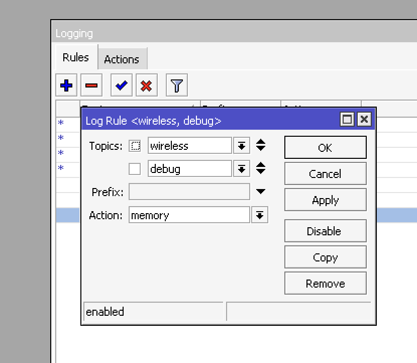

I have tried to activate the wireless debug log, but I still only see messages with the topic “wireless, info”. Do I need to take other steps to enable debug logging with wifiwave2?

In this case, in your mikrotik router, add Logging rule like this. Then see in Log section, what is written, when you try to make the connection
That’s exactly what I’ve done. But this is all I got in the log:
