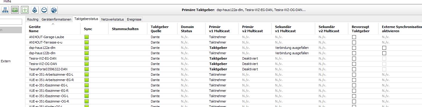

I am trying to build a larger Dante Setup at my house and I am facing issues with multiple Dante Clock leaders, which is normally due to the PtP Clock not being transmitted ideally. “Taktgeber” means leader in German

The 4 leaders are located on the Capsman - Router Switch, the Switch EG, the Switch OG and the Switch Büro. All got 10 GBit links to the Core switch, the Capsman Router.
And I got a basic VLAN Setup with 5 VLANs: 1 for most control things, 10 for Smart Home devices, 20 for guests, 30 for Home Office Stuff, 40 for Dante and 50 for Cameras. As you see, there are also some WiFi APs in the system.
I suspect QoS or PtP being an issue here, because playing with the Multicast Router and learn option on the Interfaces made things go more into the direction I wanted them to go.
