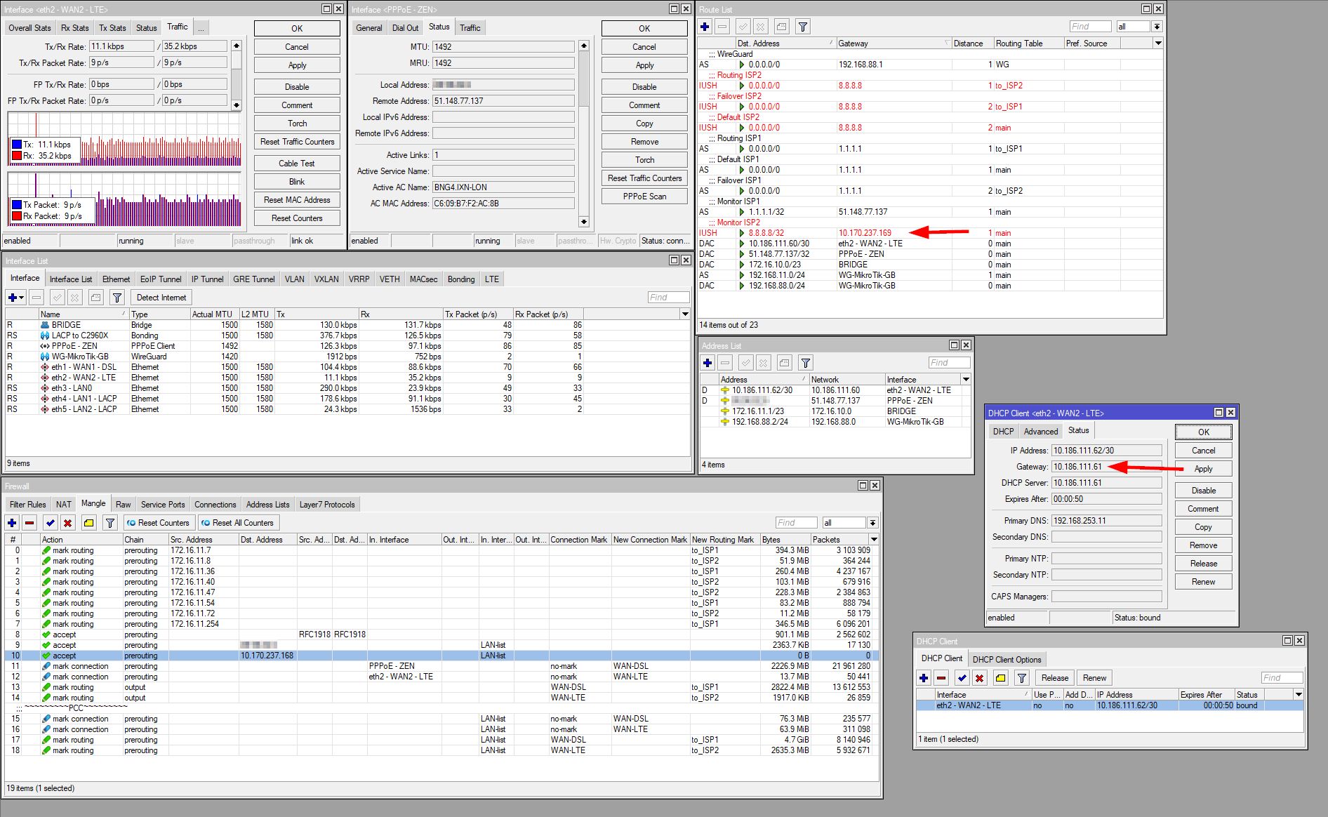

Hello all,
I have this need also, but I can’t figure out how to make use of this script,
See the attached 2 instances where I had to manually update the gateway on my 2 routes.
Any assistance will be greatly appreciated.
Many thanks,
B

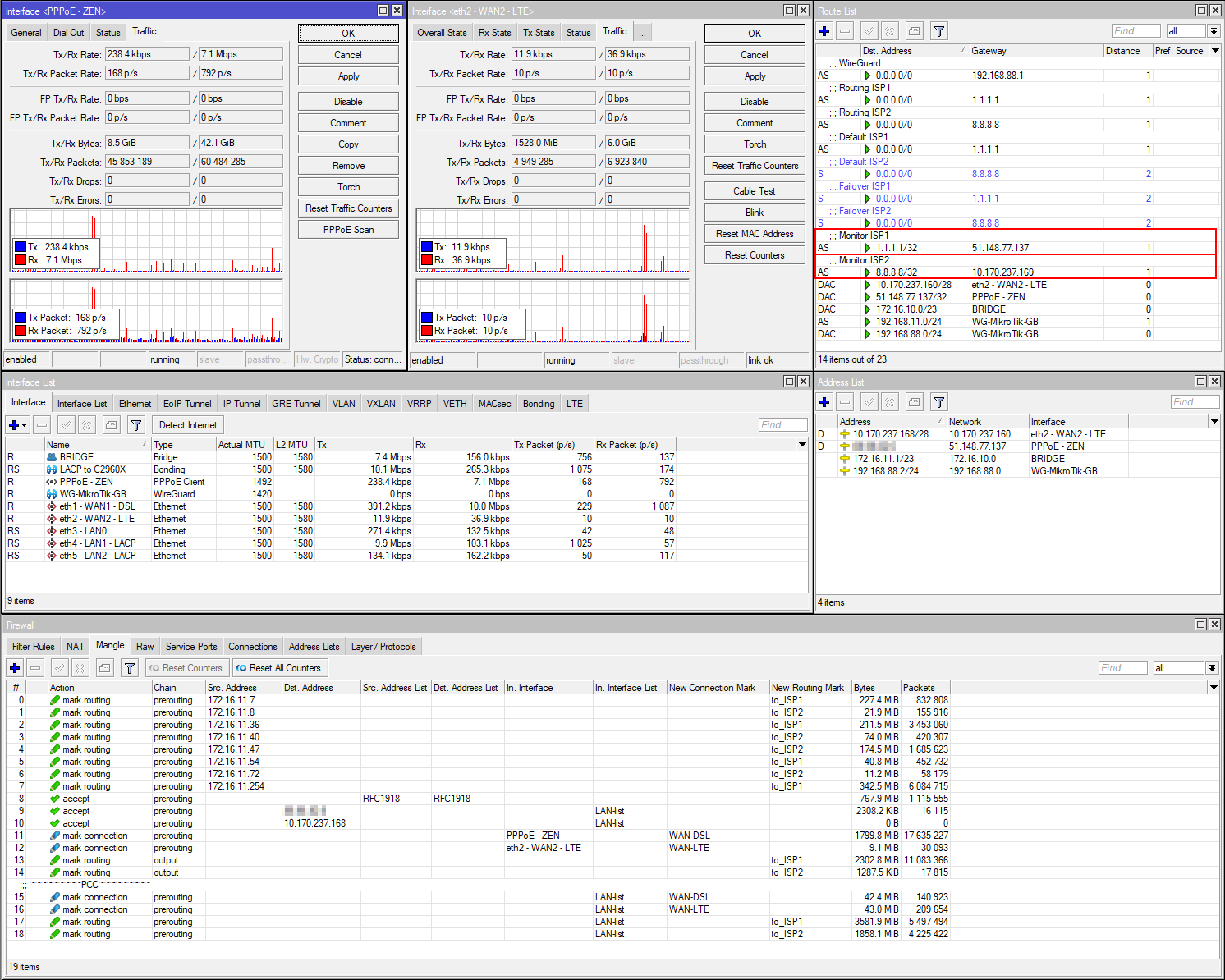

It’s confusing. From the screenshot, looks like you’re recursive routing. You don’t need a script if you want the dhcp client to add a route with a 0.0.0.0/0 to the obtained IP from DHCP.
However with recursive routing, the default route goes to your canary address (8.8.8.8 in mikrotik’s examples). But you need the 8.8.8.8 route to use IP obtained from DHCP (e.g. a WAN IP). So the idea with the script is you do NOT add a default gateway, but instead the script will locate the 8.8.8.8 route, and set the dst address as the DHCP one.
So if you use “Monitor ISP1” and “Monitor ISP2” as the comment field in the script you should be fine. I was providing a richer example, but you just need to update the 1.1.1.1 and 8.8.8.8 routes with the DHCP address – so comment is pretty easy here.
Hey @Amm0, based on your location, you’re up early, or staying up late!
You’re right, I am using recursive routing, and I got the fact that I only need to update the existing “Monitor ISPx” route with the new gateway acquired via DHCP client on eth2-WAN2-LTE interface.

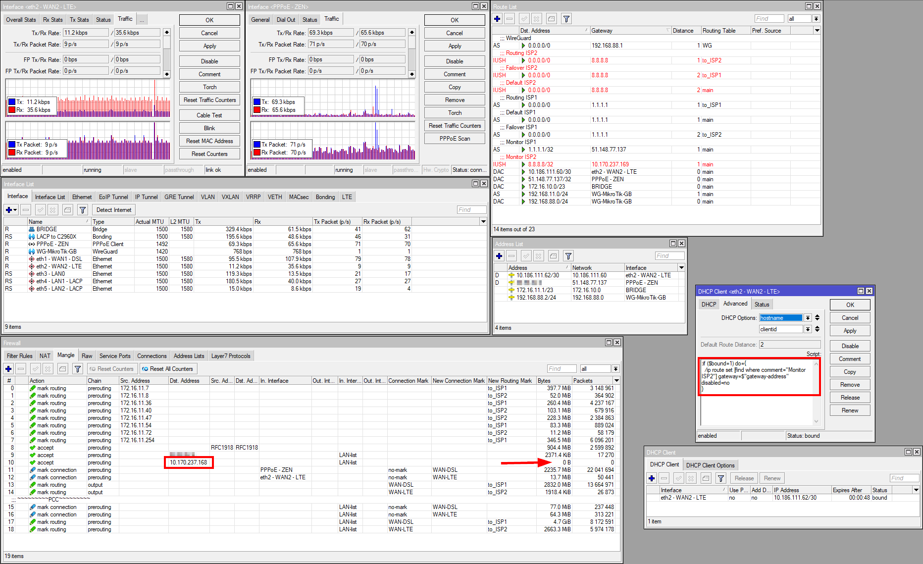

So since it’s happened (see attached) I am right in using the script as per the following screenshot?
Also within the second screenshot, I’m wondering how am I supposed to update that prerouting accept mange rule although it seems to do nothing given no packets are being captured by it???

Basically you can modify any code in the DHCP client, so you can just add another line in the script for the mangle rule. So if you add the same comment to your firewall rule as your /ip/route, it works the same to update that one. Just another line of config:
:if ($bound=1) do={
  /ip route set [find where comment~"Monitor ISP2"] gateway=$"gateway-address" disabled=no
  /ip firewall mangle set [find comment~"Monitor ISP2"] disabled=no dst-address=$"gateway-address"
} else={
  /ip route set [find where comment~"Monitor ISP2"] disabled=yes
  /ip firewall mangle set [find where comment~"Monitor ISP2"] disabled=yes
The “set” updates an existing entry, but it need to locate one… that where the [find xxx] syntax comes from, and it works for any command. The “trick” is to use a comment since that make the script easier than search for specific/unique attributes. Thus a comment provides the fixed reference for the script – so as long as you don’t mess with the comment fields this approach works.
Also I did use ~ instead of =
what that does is look for the substring “Monitor ISP2” – just in case a space is added by mistake. The ~ is a regex but functions as a substring search. The = requires the comment text to match exactly.

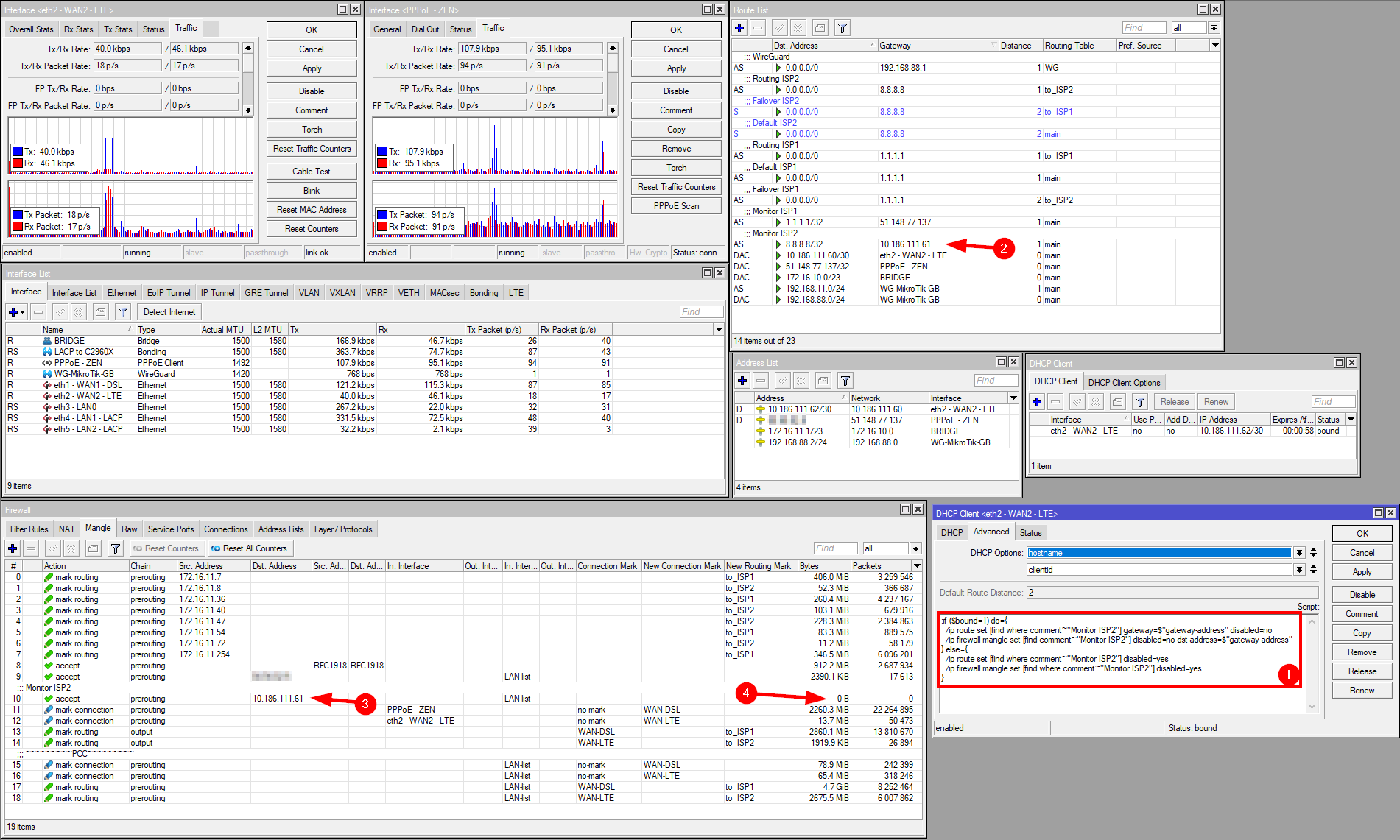

Thanks Amm0,
That worked like a charm after releasing the old IP!!
Now before I would kindly ask for your input on the ISP1 scenario, why do you think no packets are being captured by this mangle rule (point 4 in the screenshot attached) considering that both WANs are successfully being used via PCC??
Hard to say exactly. But not a lot of chances for a LTE with CGNAT to get incoming connections to the router. LTE be mostly forwarded traffic from LAN clients, and covered by an established/related in firewall filter.
OK, thank you Amm0, that makes sense…
Now onto the final point… Where do I start with applying the same/similar script to update the ISP1 route gateway address using the remote address/network from the PPPoE interface?
