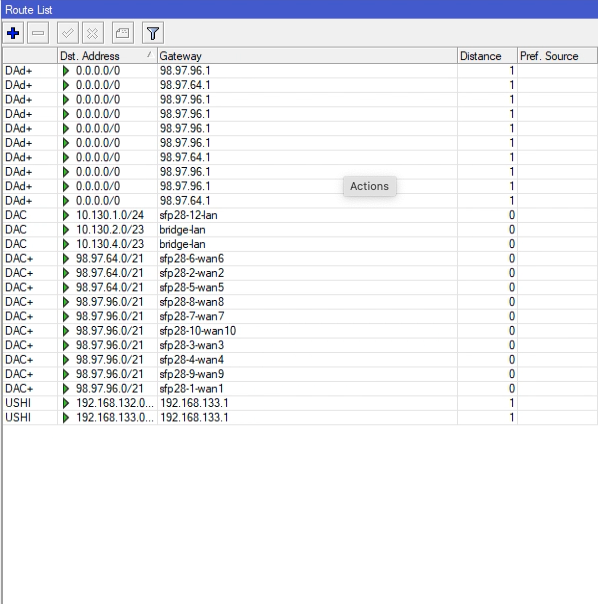

I am a Network Engineer managing a WISP setup in a remote Alaskan tribal village. Last week I was on-site and replaced our middle-mile Internet connection from OneWeb which was very costly and underperforming with 10 high performance Starlink terminals. I have set the IP policy to public IP on all the terminals and using the DHCP client on each of the 10 interfaces on our MikroTik router and configured to automatically add the default routes since Starlink does not offer true static IP addresses and we have no other ISP options available in this very remote area. I see it automatically setup ECMP load balancing and that appears to be working as I can see traffic being distributed across all 10 WAN interfaces and data usage also appears almost equal on each terminal in the Starlink portal.
The problem we are now facing is this setup broke the secure connection between the MikroTik and our Sonar billing instance which controls the LAN DHCP server. Our L2TP/IPSEC VPN no longer works. I figure this is because how traffic is routed out one WAN interface and comes back through a different WAN interface therefore the source IP is keeps changing.
I’ve done a bit of research on this and also watched a few YouTube videos of MikroTik engineers setting up MultiWAN scenarios using PCC with routing marks and separate routing tables for each WAN interface. The difference is in the videos, only 2-3 WAN connections were used and the ISPs were different. However, I have not been as successful with getting this to work as all of the IP addresses Starlink as assigned are in the same subnet and have the same gateway. I know using 10 Starlinks might seem a bit extreme but that was not my decision.
I would like to ask for some guidance in getting this setup to work and fix our secure connections so the village can begin billing customers. Our company is also willing to consider hiring a MikroTik expert to work with us on a consultancy basis to get this to work if there is someone on here available and has proven experience with this scenario. I do consider myself knowledgeable with MikroTik and have formal education in Networking but will admit this is my first attempt at setting up something of this magnitude. I am a quick learner and love all things MikroTik and Networking related so I am willing to listen and learn from anyone on here who knows more about this than I do.
I am attaching a copy of our config with sensitive info removed as well as screenshots of our System > Resources and IP > Routes for reference.

Okay you have other issues.
Your way of separating users and use of vlans and bridge is very confusing.
You have only one pool but then many addresses, whats going on.
Looks like you should have 3 vlans, subscribers group1, subscribers group2 and servers.
One bridge-lan is fine, assign the three vlans (2,4,6) to the bridge, etc.
3 pools, 3 ip dhcp servers and 3 ip dhcp server networks to go along with three IP addresses with interface being the applicable vlan!!!
All are a trunk port on sfp28-12 to the switch
add bridge=bridge-lan ingress-filtering=yes frame-types=admit-only-vlan-tagged interface=sfp28-12
/interface bridge vlan
add bridge=bridge-lan tagged=bridge-lan,spf28-12 vlan-ids=2,4,6
I think what you need to do is for all the default routes display them as such…
add dst-address=0.0.0.0/0 gateway=98.97.96.1%spf28-1-wan1 routing-table=main
add dst-address=0.0.0.0/0 gateway=98.97.96.1%spf28-2-wan2 routing-table=main
add dst-address=0.0.0.0/0 gateway=98.97.96.1%spf28-3-wan3 routing-table=main
etc…
Then MANGLE rules, have no clue what your mangle rules are doing???

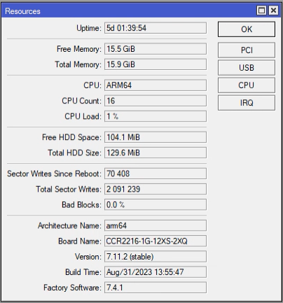

So I finally got to reading through it, and I am trying to put the bits together.
You wrote that the public IP addresses assigned by Starlink with the high priority subscription were changing but now they are not, but if I get it right, the L2TP/IPsec tunnel still keeps disconnecting (or is not connecting at all)?
Second, I cannot see any L2TP configuration in the export nor a dst-nat rule for IPsec ports, so I figure the L2TP/IPsec client is running in Alaska on some device connected to the 2216’s LAN and connecting to a server at your HQ location, is that correct?
ECMP used to be working on RouterOS 6 where a routing cache existed, so if a connection started using a particular gateway, it continued using it until the routing cache was flushed. I’m not sure whether ECMP can be used on RouterOS 7, which uses a kernel that does not support routing cache any more, when src-nat is engaged, because I don’t know how a Starlink terminal treats packets with a wrong source address. But since you encounter problems, I would first dig in this direction. The thing is that the firewall rules assign the “external” address of a src-nated connection (officialy, the reply-dst-address) once for good while handling the initial packet of the connection. So if ECMP sends a subsequent packets belonging to the same connection via another gateway, that packets will leave with an address that does not belong to the one of the out-interface, so if the Starlink network is picky about it, it will not reach the destination.
If my assumptions above regarding the L2TP/IPsec topology, Starlink behavior, and ECMP behavior in ROS 7 are correct, you need to make sure that the L2TP/IPsec connection keeps using the same WAN all the time; to do that, you need to make it use a dedicated routing table that prefers a particular WAN and only uses another one if the primary one fails, so that the tunnel could re-establish.
Before proceeding, please confirm or correct my understanding.

[b]Routes:[/b]
add disabled=no dst-address=192.168.132.0/24 gateway=192.168.133.1 \
    routing-table=main suppress-hw-offload=no
add disabled=no dst-address=192.168.133.0/24 gateway=192.168.133.1 \
add disabled=yes dst-address=0.0.0.0/0 gateway=98.97.96.1%sfp28-1-wan1 \
add disabled=yes dst-address=0.0.0.0/0 gateway=98.97.64.1%sfp28-2-wan2 \
add disabled=yes dst-address=0.0.0.0/0 gateway=98.97.96.1%sfp28-3-wan3 \
add disabled=yes dst-address=0.0.0.0/0 gateway=98.97.96.1%sfp28-4-wan4 \
add disabled=yes dst-address=0.0.0.0/0 gateway=98.97.64.1%sfp28-5-wan5 \
add disabled=yes dst-address=0.0.0.0/0 gateway=98.97.64.1%sfp28-6-wan6 \
add disabled=yes dst-address=0.0.0.0/0 gateway=98.97.96.1%sfp28-7-wan7 \
add disabled=yes dst-address=0.0.0.0/0 gateway=98.97.96.1%sfp28-8-wan8 \
add disabled=yes dst-address=0.0.0.0/0 gateway=98.97.96.1%sfp28-9-wan9 \
add disabled=yes dst-address=0.0.0.0/0 gateway=98.97.96.1%sfp28-10-wan10 \
    routing-table=to_wan1 suppress-hw-offload=no
    routing-table=to_wan2 suppress-hw-offload=no
    routing-table=to_wan3 suppress-hw-offload=no
    routing-table=to_wan4 suppress-hw-offload=no
    routing-table=to_wan5 suppress-hw-offload=no
    routing-table=to_wan6 suppress-hw-offload=no
    routing-table=to_wan7 suppress-hw-offload=no
    routing-table=to_wan8 suppress-hw-offload=no
    routing-table=to_wan9 suppress-hw-offload=no
    routing-table=to_wan10 suppress-hw-offload=no
[b]Routing Tables:[/b]

I came across this post that looks like it might have some useful information and wanted to get your thoughts on it. http://forum.mikrotik.com/t/pcc-load-balancing-and-https-connection-issues/78143/1
The poster suggests changing passthough=yes to passthrough=no. I also currently have only one srcnat masquerade rule to a WAN interface list that has all my WAN interfaces in. Will that work or should I have a separate masquerade rule for each WAN interface?
Back to my question about the NEED_PCC list. It’s my understanding that PCC will solve my issue with secure connections including our L2TP/IPSEC VPN not working. Customers are currently not able to visit HTTPS sites without getting privacy warnings as they have reported to me and our VPN client on the MikroTik router is unable to connect to office VPN server in Oregon when it used to work when we only had 1 WAN connection. Am I correct in my thinking that all my LAN subnets will need PCC and therefore I should add them all to that list? I would think all customers should get PCCd since pretty much everything we do online these days is secure and most modern browsers default to it. Thoughts on this?
Jaysen
ECMP works fine V7 – it relies on connection tracking to store the routing decision for future packets. I’m not sure that’s the problem here. I suspect it just the variable the speed of starlink sats moving is going to be same across all 10 terminals (e.g. one is slow, all will likely be slow)
The LTE being 600ms would imply the cell networks backhaul is using GEO sat, which at a full transponder would be ~50-100Mb capacity range.
Hello Sindy,
Regarding the Starlink public IP addresses. We were told by Starlink that they do not offer static IP addresses. The public addresses are assigned by DHCP but they said they are static leases or “sticky” as they called it. The only time they could change is if they had to failover our connections to another ground station for whatever reason. Otherwise, they said the IP addresses won’t change. I hope that clears that up. Sorry if it was confusing when I first explained it.
The L2TP client is running directly on the Mikrotik router in Alaska and it connects to another Mikrotik router at our HQ in Oregon running the L2TP server. That was working great prior to changing over to the 10 starlinks. It worked with our previous OneWeb connection and also with just 1 starlink after we got rid of OneWeb. We have been operating on 1 starlink for the past few months temporarily until last week we made the switch to 10 priority dishes which broke it. The logs are now showing it trying to connect but it always fails, then retries, then fails again. It never does successfully connect
You are correct, we have no dst-nat rule for L2TP setup and currently no filter rules at this time that would block any incoming connections. I decided to keep it open for now while I am trying to get this load balancing and PCC working. Then I will go back and work on securing it. I do have a few dst-nat rules that point to some servers on the local server subnet but I would like to get rid of those once the VPN is working again.
Thank You,
Jaysen

Then something must have gone wrong in the process of posting the configuration, because I can see no /interface l2tp-client section there.
There are also multiple routing tables but just two static routes in the configuration.
If the L2TP client is running directly on the 2216, no dst-nat rule is necessary, it’s just that there absence of the client configuration in the export made me think it is running on another device so I was thinking of possible topologies (an L2TP server in LAN in Alaska would require a dst-nat rule).

I had removed some sensitive data in the config before posting it. That’s likely why it wasn’t in there. The original config contained complete address lists with customer info in them so I removed all that. Here is the most recent config with address list data removed.
# 2023-11-14 14:51:49 by RouterOS 7.12
# software id = DVNU-PTAC
# model = CCR2216-1G-12XS-2XQ
# serial number = HE808NY9TF8

OK. Now let me clarify some points that may not be obvious.
First a disclaimer - I am aware that you have inherited most of the current configuration from the previous administrator, so if I occasionally say “you use”, it is just an abbreviation of “I can see in the configuration”.
  • this point may seem a cosmetic one, but it needs to be clarified to avoid issues in future and to explain the background of some suggestions. @anav has given you a template configuration that uses connection marks as a basis for assignment of routing marks; the “pre-anav” configuration uses connection marks as a basis to assign packet marks to be further used to choose QoS queues. Unfortunately, Mikrotik’s wrapper to netfilter allows at most one connection mark per connection; luckily, the way the connection marks are used for QoS purposes in the pre-anav configuration is clearly a consequence of copy-pasting some template without really understanding it and it can be redone do work the same without use of the connection marks. Another positive point is that in your particular setup, you probably don’t need to use the connection marks for routing either.
  • the reason why you have to set the gateway parameters of the routes in the form ip.add.re.ss%interface-name is that even if the Starlink network accepts packets sent with a “wrong” source address through a particular terminal, I suppose the bandwidth limitations apply per terminal, not per source address (but only X can confirm this). Since all leases from the same /21 use the same address of the gateway, setting the gateway parameter to IP address alone (which is what the DHCP client normally does) is not sufficient for the routing to choose a particular interface.
    However, the screenshot you have posted shows that your WANs get own addresses, and therefore also gateways, from at least two different subnets. So although the leases are “long-term stable”, we cannot risk that the gateway addresses in the manually configured routes would stop matching the real gateway addresses once the leases change, so we need to use a lease script to update the route configuration, not only in the dedicated routing tables but once at it, also in the default routing table (called main). It’s RouterOS 7 so I’ll have to do some tests before giving you a script to apply - I am well aware of those 2000 miles.
Those are dogsled miles :slight_smile:
Your second point lost its train of thought…
the reason why… if that even if… ???
So here’s how to make the DHCP clients add/modify the routes the necessary way.
First, copy-paste the following script to the command line window of the router. The exported form looks awful, but it is not invoked until you change other things in the configuration, so you can paste the creation script from and then open the created script named lease-script in the GUI or command line editor to see it in a more user friendly way.
/system/script/add name=lease-script source=":if (\$bound=1) do={\
    \n  /ip route {\
    \n    :if ([:len [find where dst-address=0.0.0.0/0 gateway~(\"%\".\$\"interface\") !dynamic !blackhole routing-table=main]]=0) do={\
    \n      add gateway=(\$\"gateway-address\".\"%\".\$\"interface\")\
    \n    }\
    \n    :foreach r in=[find where dst-address=0.0.0.0/0 gateway~(\"%\".\$\"interface\") !dynamic !blackhole] do={\
    \n      set \$r gateway=(\$\"gateway-address\".\"%\".\$\"interface\")\
    \n    }\
    \n  }\
    \n}\
    \n"
Once the script is added and you make yourself comfortable with what it does, you can test the following steps for one of the DHCP clients (choose the N in the command as required):
/ip/dhcp-client/set [find where interface=sfp28-N-wanN] script=lease-script add-default-route=no

In the last configuration you’ve posted, the statically configured routes are already present even in table main, so they will get only updated, not added (unless you remove them before). But as the dynamically added one will be removed due to the change of add-default-route to no, you’ll have to enable the disabled static route in main.
There may be a catch - you have renamed the sfp28-N interfaces to sfp-28-N-wanN, and I had some fun with that when testing it here. I have created and assigned the dhcp script while the interface had a custom name, but then decided to reset the custom name back to the default one. Nevertheless, the script kept using the old custom one; deleting and recreating the dhcp client was not enough to sort that out, but disabling and re-enabling the inteface did. Any questions that might arise are not to me, thank you :slight_smile:
If you can see the expected outcome, which is to have a route via sfp28-N-wanN with the correct gateway address in the configuration as a static one, you can do the same for one more DHCP client. My plan is to let the L2TP client use those two before eventually extending the approach to all of them.
All the above is still just an intermediary step. My feeling is that with all uplinks served by the same satellite constellation, most of the outages will be affected by poor satellite visibility and will thus affect all of them, yet still we’ll have to add means to notice and stop using a broken terminal, but that’s for later.
Maybe consider adding some monitoring of the starlink performance — which is kinda annoying since it use gRPC, not SNMP. I know there is starlink plugin for Prometheus, but if you have some other NMS somewhere… imagine there are plugins for starlink. The terminal’s gRPC data includes stuff like max speed, # sats, etc. if you know that it be easier to find where fault lies down the road.
All the Starlinks I happen to deal with are remote ones so I never delved into monitoring of the terminal, assuming that the owner’s app shows you something. What I had in mind was the “good old” monitoring of uplink transparency all the way to internet, preventing the situation where the WAN interface is physically up so the router keeps using it although the packets sent through that interface get nowhere due to an outage further in the ISP network.
But some weeks ago I was wondering whether the location data could be retrieved from the Starlink and haven’t come across gRPC when googling. Once the 7.13 (with its capabilities to interwork between json and variables) becomes stable, I guess I’ll give it a try.
Thank you Sindy for the script. I was starting to wonder how I was going to handle changing the routes in the event our IP addresses change. I didn’t want to do it manually especially if any change occurred in the middle of the night or otherwise working with other clients and out of reach so this is very helpful. I am going to create that now.
I do apologize about the interface names. I had just added -wanN to the end of the default names but willing to rename them to simplify things if necessary. I am very flexible with any changes as is our client. They’ve lived with terrible or no internet most of their lives so they are very understanding and know I am working to make things better for them.
Good news about the satellite visibility is this village is in an area of Alaska that is high up and visibility should be of no concern as we were told by Starlink. The site is wide open with little to no obstructions and so far performance has been very impressive. OneWeb can’t even begin to compete and the village has made sure I knew that. Even with the fraction of a percent obstruction that Starlink dashboard is showing on a few of the terminals. Single strength is very strong and latency is low.
I did rework some of mangle rules late last night prior to seeing your post this morning. I found this guide on the MikroTik site that seems very informative. https://mum.mikrotik.com/presentations/PL10/balancing.pdf Attached is my latest config although it sounds like I may not need all the connection marks as you mentioned so we can get rid of anything that is not needed. I did have a question about the failover section and while I did set the distances in the routes. I am starting to wonder whether I even need to do that since all the gateways are the same on most of the terminals so if it goes down then it seems like it would be down for every connection that uses the same gateway?
To your point of copying-pasting configs without fully understanding. While it made me laugh, it’s a very valid point and I do this quite a bit when I am playing around to see how things will work. I do always make sure to back up my original configs so I can recover in the case I mess up and that has gotten me in the past. :laughing:
Again I appreciate you and everyone else for being patient and working with me on this.

add check-gateway=ping disabled=yes distance=1 dst-address=0.0.0.0/0 gateway=\
    98.97.96.1%sfp28-1-wan1 routing-table=main suppress-hw-offload=no
add check-gateway=ping disabled=yes distance=2 dst-address=0.0.0.0/0 gateway=\
    98.97.64.1%sfp28-2-wan2 routing-table=main suppress-hw-offload=no
add check-gateway=ping disabled=yes distance=3 dst-address=0.0.0.0/0 gateway=\
    98.97.96.1%sfp28-3-wan3 routing-table=main suppress-hw-offload=no
add check-gateway=ping disabled=yes distance=4 dst-address=0.0.0.0/0 gateway=\
    98.97.96.1%sfp28-4-wan4 routing-table=main suppress-hw-offload=no
add check-gateway=ping disabled=yes distance=5 dst-address=0.0.0.0/0 gateway=\
    98.97.64.1%sfp28-5-wan5 routing-table=main suppress-hw-offload=no
add check-gateway=ping disabled=yes distance=6 dst-address=0.0.0.0/0 gateway=\
    98.97.64.1%sfp28-6-wan6 routing-table=main suppress-hw-offload=no
add check-gateway=ping disabled=yes distance=7 dst-address=0.0.0.0/0 gateway=\
    98.97.96.1%sfp28-7-wan7 routing-table=main suppress-hw-offload=no
add check-gateway=ping disabled=yes distance=8 dst-address=0.0.0.0/0 gateway=\
    98.97.96.1%sfp28-8-wan8 routing-table=main suppress-hw-offload=no
add check-gateway=ping disabled=yes distance=9 dst-address=0.0.0.0/0 gateway=\
    98.97.96.1%sfp28-9-wan9 routing-table=main suppress-hw-offload=no
add check-gateway=ping disabled=yes distance=10 dst-address=0.0.0.0/0 \
    gateway=98.97.96.1%sfp28-10-wan10 routing-table=main suppress-hw-offload=\
    no
    98.97.96.1%sfp28-1-wan1 routing-table=to_wan1 suppress-hw-offload=no
    98.97.64.1%sfp28-2-wan2 routing-table=to_wan2 suppress-hw-offload=no
    98.97.96.1%sfp28-3-wan3 routing-table=to_wan3 suppress-hw-offload=no
    98.97.96.1%sfp28-4-wan4 routing-table=to_wan4 suppress-hw-offload=no
    98.97.64.1%sfp28-5-wan5 routing-table=to_wan5 suppress-hw-offload=no
    98.97.64.1%sfp28-6-wan6 routing-table=to_wan6 suppress-hw-offload=no
    98.97.96.1%sfp28-7-wan7 routing-table=to_wan7 suppress-hw-offload=no
    98.97.96.1%sfp28-8-wan8 routing-table=to_wan8 suppress-hw-offload=no
    98.97.96.1%sfp28-9-wan9 routing-table=to_wan9 suppress-hw-offload=no
    gateway=98.97.96.1%sfp28-10-wan10 routing-table=to_wan10 \

Depending on the order of creating the DHCP client, renaming the interface it is attached to, and possibly rebooting the router in the past the result may be different. The lease script uses the interface name to find, add, and modify the routes, and on my test router it was remembering the previous name. So forcing the DHCP client to renew an address after adding the script using /interface/ethernet/disable sfp28-N-wanN ; delay 2s ; /interface/ethernet/enable sfp28-N-wanN rather than /ip/dhcp-client/release [find where interface=sfp28-N-wanN] may be a better choice after renaming the interface or if you are not certain.
Frankly speaking the simulation at starlink.sx has scared me a lot as it is showing long (as in tens of minutes) outages in coverage for Unalakleet, so I hope they are using outdated/inaccurate data. LEO satellites are superior to geostationary ones for both delay and throughput per square mile of coverage. Far lower distance to travel so far lower delay, far lower attenuation to compensate, and far bigger area to cover by a single antenna with a given throughput. But in these areas, polar trajectories seem to be mandatory so it’s more or less a separate (from the main one covering the belt from 52°S to 52°N) Starlink constellation. And OneWeb probably didn’t get that far (yet) so geostationary is their only choice for those areas.
From my experience with other Starlink installations in “bypass” mode, the gateway is probably redundant - if you look into the ARP table, you will probably see the MAC addresses of all (currently “both”) the gateway IPs to begin with 00:00:5E:00:. So it is more likely that all your terminals lose connection than that a gateway in just one of the subnets becomes unreachable.
So I maintain my previouos position that we have to deal with issues we have to capacity to deal with, i.e. a breakdown of a single terminal. The only satellite within reach gone bonkers does not fit into this category.
As for route distances - these determine the priority among routes whose dst-address and routing-table parameters are identical. If multiple such routes are eligible for being active, those with the lowest value of distance are actually made active, and if there are multiple such ones, they are used in a round-robin manner (ECMP). So as @anav probably wrote earlier - in order that failover and load distribution worked in accord, you need to have one routing table per uplink that is used for traffic that should prefer that uplink but can send the traffic via other uplinks if the preferred one becomes unusable. In the simplest to configure case, you define just one backup uplink for each preferred one, so if the preferred one dies, the backup one has to bear its full load on top of its own one. In the optimized case, the load of the failed link is evenly distributed among all the remaining ones. So much more lines of configuration with much more room for mistakes but potentially less impact on customers if a terminal eventually fails. Choose your poison.
So for starters, let me give you an example for the L2TP, which is the most wanted functionality right now I gather.
You’ll add a routing table named for-l2tp with two routes, one with distance=1 and the other one with distance=2, using the two WANs for which you have modified the DHCP client behavior. Let’s say you’ve chosen WAN 9 and WAN 10:
/routing/table/add name=for-l2tp fib
/ip/route/add routing-table=for-l2tp gateway=1.1.1.1%sfp28-10-wan10 distance=1
/ip/route/add routing-table=for-l2tp gateway=1.1.1.1%sfp28-9-wan9 distance=2
By forcing a release followed by a re-lease (pun intended) of the DHCP address as described above, you’ll trigger the lease script that should replace the 1.1.1.1 by the correct addresses of the respective gateways in these routes.
There are multiple possible ways to make the L2TP connection use this table; since the own WAN addresses of the Mikrotik are dynamic and since you identify the VPN server by its fqdn, so I assume its IP address may also change, all these ways require that the routing table to be used was assigned using mangle rules in chain output.
So let’s make any connection from the router itself to your VPN server use this routing table. To make sure it won’t break once the server migrates to another IP address, we’ll add an address list to track the fqdn:
/ip/firewall/address-list/add list=re-vpn address=vpn.richesineng.com
It should create a dynamic item in the same address list but with the actual IP address as address. If it doesn’t, something is wrong with the DNS setting.
Then, you add a single rule to the very top of chain output in mangle (which is easy as that chain is totally empty now):
/ip/firewall/mangle/add chain=output dst-address-list=re-vpn action=mark-routing new-routing-mark=for-l2tp passthrough=no
It seems this should be it; there is an additional issue, though. A packet sent by the router itself must first be routed using routing table main before it can get to mangle chain output, so it gets assigned some source address depending on the out-interface chosen by main. If mangle assigns a routing-mark to it, the routing is done again, but the source address remains the same. So a src-nat (or masquerade) rule must replace it by the address of the out-interface. This is OK until the uplink connected to that out-interface stops working without the interface going physically down. The connection tracking only removes the connection from its inventory if it has been src-nated using a masquerade rule and if the reply-dst-address assigned by the masquerade rule goes missing. Starlink seems to lease the addresses for 5 minutes (but that’s for CGNAT ones, the public ones may be treated in a different way); if you are happy with the L2TP connection being re-established some 5 minutes after the preferred uplink goes down, nothing else needs to be done. If not, it requires a housekeeping script that removes the address as soon as it detects the failure of the uplink. But again, step by step. Right now I’ll be glad if you make the L2TP work without fancy stuff.
If these settings won’t get the L2TP going, I’ll have to see it online.
