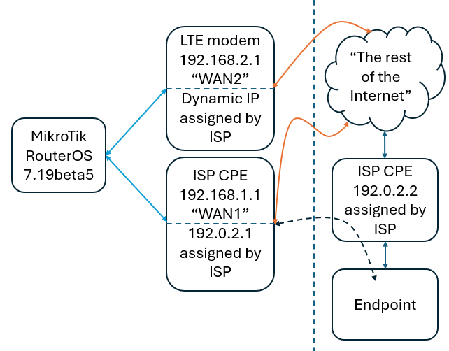

Please draw a diagram to show the equipment involved here as your explanation is not making sense.
It would seem as though either you or the ISP has their own firewall device besides their modem and your MT
I just cannot figure if its between the two or on the far side the ISPs modem…

That’s a good point. I post here the config and a diagram.
Thank you for looking over the situation.
You are correct. There is a device that is filtering packets in front of the far endpoint to allow only the connections with the static IP assigned by my ISP.
I have entered that into the diagram.
The setup works perfectly when I have the LTE modem unplugged (when there is only one functional route).
Yes. The traffic is supposed to go out 50/50 on the two WAN links, except for this traffic to the one particular remote endpoint, which should only go out WAN1.

/ip firewall mangle
add action=accept chain=prerouting comment=\
    "https://www.youtube.com/watch\?v=GeuuNE3EPBA" dst-address=192.168.1.0/24 \
    in-interface=bridge
    "https://www.youtube.com/watch\?v=GeuuNE3EPBA" dst-address=192.168.2.0/24 \
    in-interface=bridge
add action=mark-connection chain=prerouting comment=\
    "https://www.youtube.com/watch\?v=GeuuNE3EPBA" connection-mark=no-mark \
    in-interface=WAN_ether1 new-connection-mark=WAN1_conn
    in-interface=WAN_ether2 new-connection-mark=WAN2_conn
    dst-address-type=!local in-interface=bridge new-connection-mark=WAN1_conn \
    per-connection-classifier=both-addresses:2/0
    dst-address-type=!local in-interface=bridge new-connection-mark=WAN2_conn \
    per-connection-classifier=both-addresses:2/1
add action=mark-routing chain=prerouting comment=\
    "https://www.youtube.com/watch\?v=GeuuNE3EPBA" connection-mark=WAN1_conn \
    in-interface=bridge new-routing-mark=to_WAN1
    "https://www.youtube.com/watch\?v=GeuuNE3EPBA" connection-mark=WAN2_conn \
    in-interface=bridge new-routing-mark=to_WAN2
add action=mark-routing chain=output comment=\
add action=change-ttl chain=postrouting comment="https://forum.mikrotik.com/vi\
    ewtopic.php\?p=838949#p840621\r\
    \nhttps://wiki.mikrotik.com/wiki/Manual:Interface/LTE" new-ttl=set:64 \
    out-interface=WAN_ether2
add action=masquerade chain=srcnat out-interface=WAN_ether1 to-addresses=\
    206.81.93.71
add action=masquerade chain=srcnat out-interface=WAN_ether2
/ip firewall service-port
set ftp disabled=yes
set tftp disabled=yes
set h323 disabled=yes
set sip disabled=yes
set pptp disabled=yes
/ip ipsec profile
add check-gateway=ping disabled=no distance=1 dst-address=0.0.0.0/0 gateway=\
    192.168.1.1 pref-src="" routing-table=to_WAN1 scope=30 \
    suppress-hw-offload=no target-scope=10
    192.168.2.1 pref-src="" routing-table=to_WAN2 scope=30 \
add comment=\
    https://help.mikrotik.com/docs/display/ROS/Per+connection+classifier \
    distance=1 dst-address=0.0.0.0/0 gateway=192.168.1.1
add comment=\
    disabled=no distance=1 dst-address=0.0.0.0/0 gateway=192.168.2.1 \
    pref-src="" routing-table=main scope=30 suppress-hw-offload=no \
    target-scope=10
add comment="to force traffic out static IP WAN1 https://forum.mikrotik.com/\
    viewtopic.php\?t=188388#p951507" disabled=no distance=1 dst-address=\
    206.81.93.160/32 gateway=WAN_ether1 routing-table=useWAN1only scope=30 \

/routing rule
add action=lookup-only-in-table comment="to send traffic bound for endpoint only through static IP WAN link https://forum.mikrotik.com/viewtopic.php\?\
    t=188388#p951507" disabled=no dst-address=198.51.100.1/32 table=\
    useWAN1only
