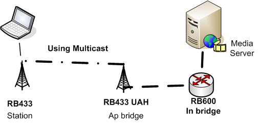

HI!!! I´m trying to stream 4 live tv channels throw RB433, RB433 UAH and RB600 as explained in the attached image (Scenario).

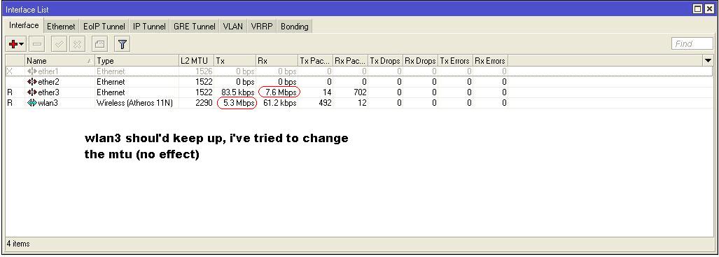

The problem is that when i try to add the second channel my first wlan doesn’t keep up with de data flow, example:
Sending 2 channels (7Mbps), the ethernet receives 7Mbps, but wlan transmits at lower rates. (No drops found or errors). See atached image.
