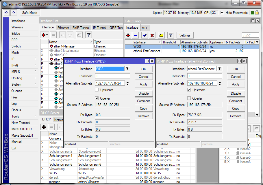

I configured this on the routerboard (v5.19):
[admin@MikroTik] > /routing igmp-proxy interface print
Flags: X - disabled, I - inactive, D - dynamic, U - upstream
INTERFACE THRESHOLD
0 U ether4-FritzConnect 1
1 WDS 1
Does anybody have some idea to get this to work?

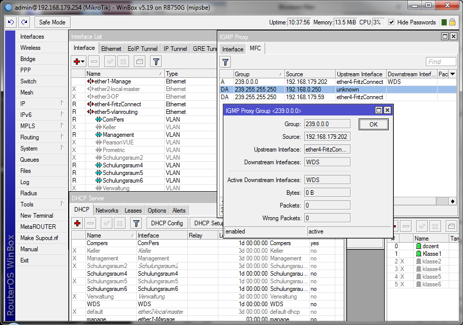

one client works, other cannot join desired group? where you see the joins (in /routing igmp-proxy mfc ?)
I can’t see them joining. I only see them in the server manager of the WDS-Server. So they got a connection to the server but I think, something is wrong with my IGMP Proxy setup.
I added my configuration screenshots.
