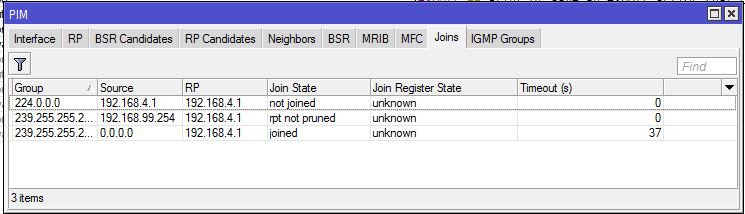

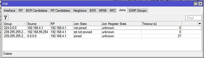

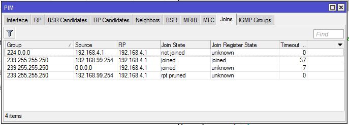

These are the router's PIM Joins status.
I cam ping/winbox one router from the other. And if i ping from the server pc to the client, i receive a reply and the opposite also.
I need help as I cannot figure out that if multicast is working or not. And honestly speaking, i dont know what server address should i give to the vlc server which is streaming the video and also what address should i give to the vlc client.
