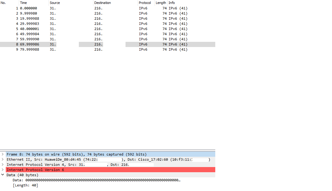

Mikrotik keepalive packets:
OMG, what is it? Can you please expand the IPv6 header?
Only nulls. And I didn’t find any replies.
Very odd. Who will reply to such packets? There should be a “Next Header” and some other important fields.
Some times the HE tunnel falls into not running state too, with keep alive enabled. But in most time HE is running with keep alive enabled unlike the NTS case. So, somehow it works. We can dig it deeper. But I don’t see a reason.
An official comment from the MikroTik team is due here. What kind of packets they use as keepalive, why, what RFC it is, or is it something proprietary etc etc. I agree that there is no use guessing but it would be good to have first hand knowledge.
