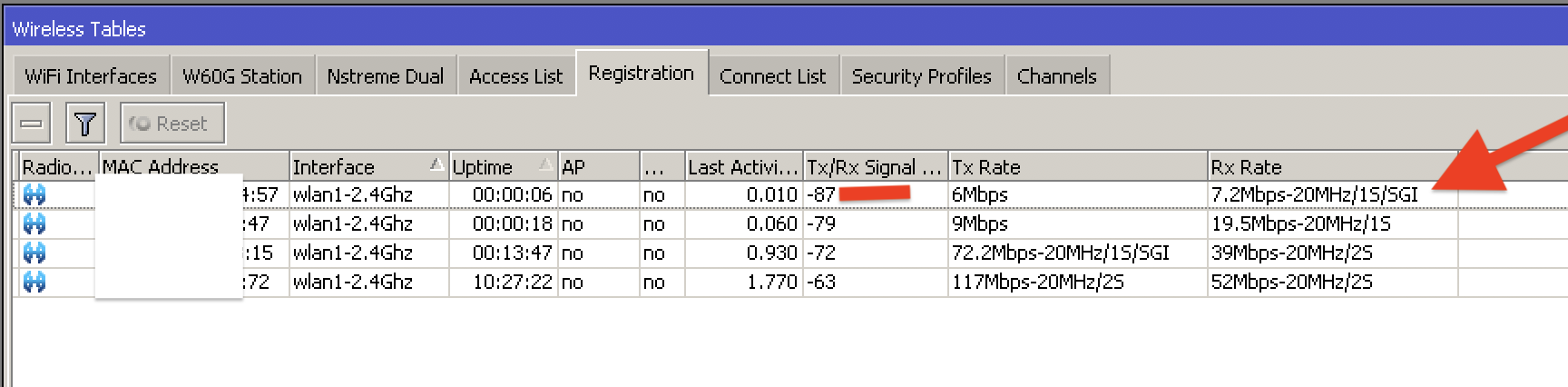

I’ve included some screenshots on the signal strength. The signal strength inside the boat is not that good, the range is -75dBm to -79dBm. From what I read I understand that this should be sufficient to be able to make a connection, is my assumption correct?

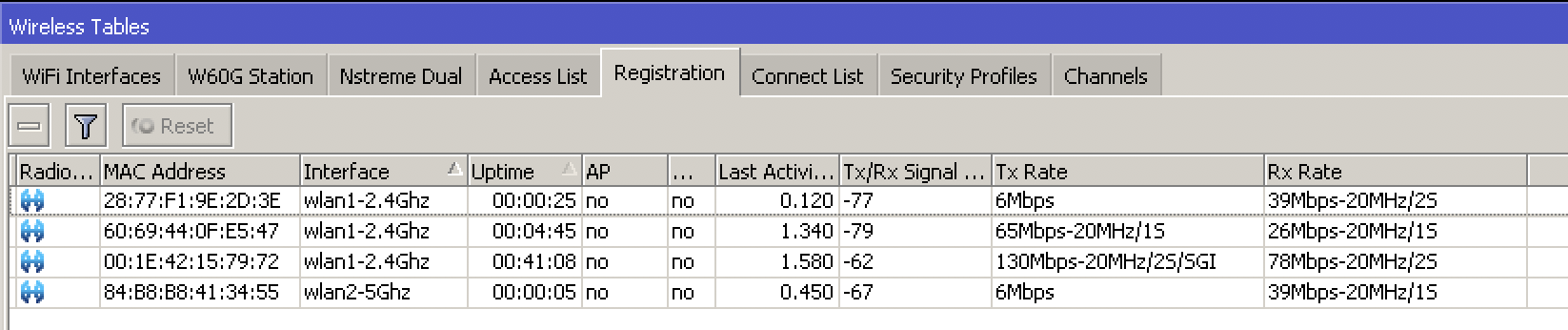

When checking other clients connected, I see signal strength from -77 and -79, they are connected to the AP, that is what I see on the screenshot. How come they can connect and I cannot connect with my MacBook Pro, iPone and iPad?

You gave almost all information. The only part that’s missing is the LOG of the AP, The LOG needs one extra topic. In System Logging add “wireless” as topics. Then you can follow all attemps and progress of the client connects. (The good ones, to be compared with the failing ones).
This wifi connection will work fine even at -86dBm (if you allow it in the access-list) So being at -75dBm is good enough for a SNR of 20 dB (noise is at -95 dBm). Ok you only get MCS1 encoding , and that gives 13 Mbps interface rate. But nothing here prevents you from connecting.

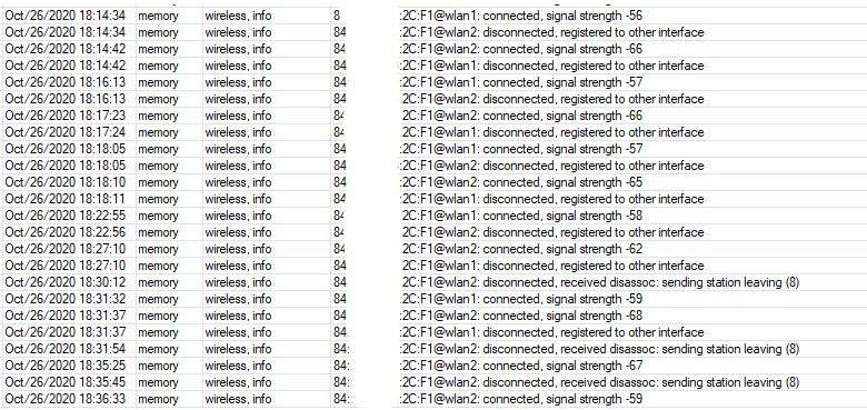

I’ve included the AP configuration and log file.
The MAC addresses have been changed by text. The “ipad_mac” is the device I’m using for testing. So this it the text to focus on.
The other MAC addresses in the log file have been changed into: Other_Mac1, Other_Mac2, Other_Mac3, etc. etc.

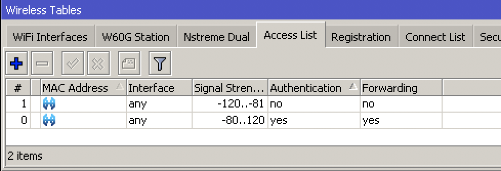

If changed the Accss List configuration to:

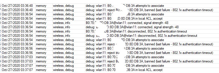

I noticed also the text “banned” in the log file for a different device. Any idea why this is?

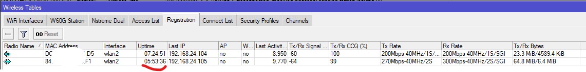

I see the iPad in the Registration list. But at the moment of taking the screenshot the signal strength was -87 (I guess this is not good) and the Access List rules will kick the iPad out of the connection.

If the signal stays below the signal strength in the allow (authorize) access-list rule , it will be disconnected after the “Allow Signal Out of Range” time given, or the default of 10 sec.
It’s only valid for that WLAN interface. -75 dBm is only good if you have better AP signal around. After the “Allow Signal out of Range” time, the default setting for the WLAN will be used.
Sending station leaving (8) : the client device is roaming on its own decision. That’s OK, it’s what we want.
Sending station leaving (3) : the AP has decided to disconnect the client.

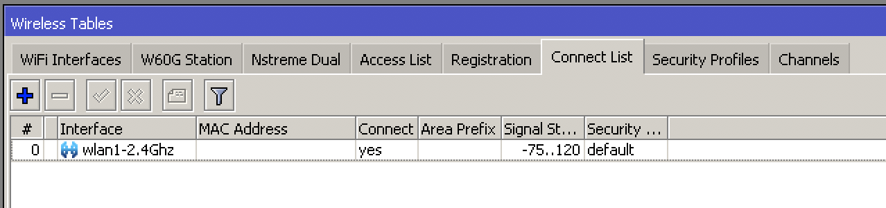

Oooops … overlooked that is was “connect list” for -75 dB
Thought and explained as if it was “access list”
“Connect list” is only used when the MKT connects to another AP (as station, station bridge, station pseudobridge, WDS slave … etc) It is not used when another device connects to the MKT.

The client device decides the connection. In the beginning between WLAN1 & WLAN2 (connect before disconnect) , at the end it was pushed a bit.(disconnect before connect)
Reason code (8) in https://aboutcher.co.uk/2012/07/linux-wifi-deauthenticated-reason-codes/ , MKT and client mechanism unknown.

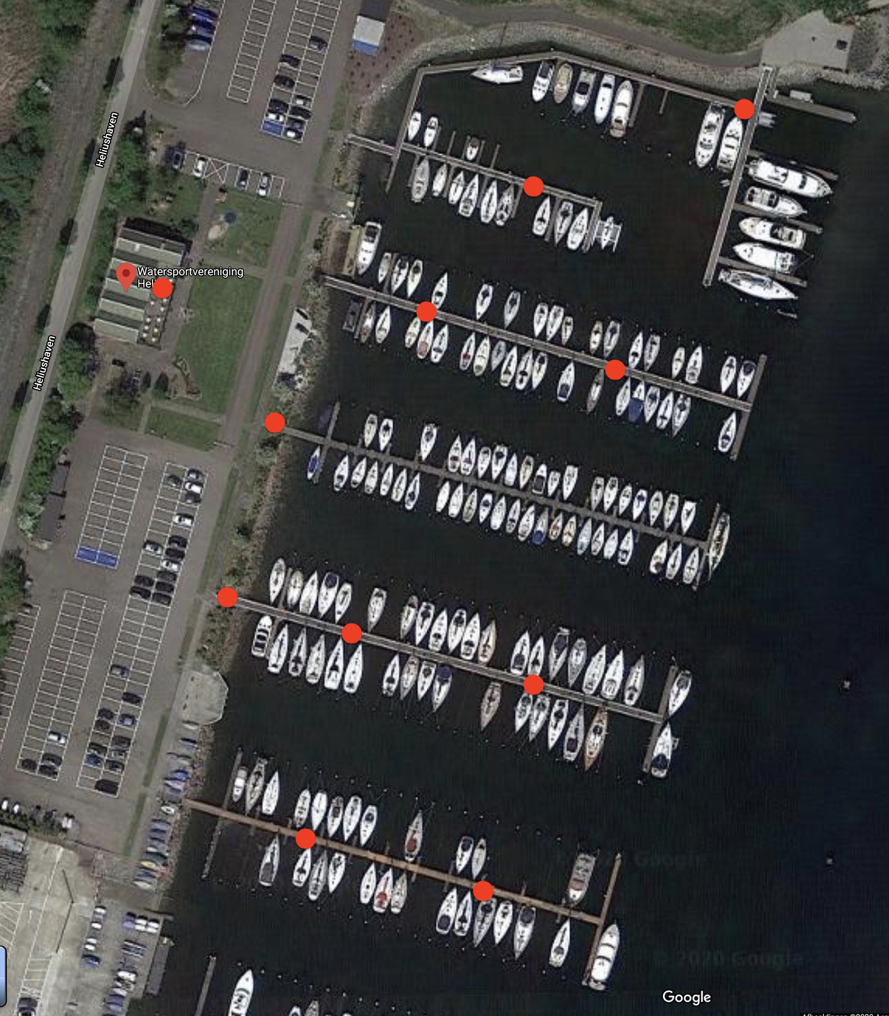

I’ve included a layout of the harbour, each red dot on the map is a AP. Mainly I’m using the wAP devices. At two locations I’m using the SXT devices. I’m covering many areas of the harbour but for sure not every spot. I’m at the end, far a way from the wAP AP and having these connection/signal strength problems.

The trigger for “banned” is probably yet another mechanism … (seen from a RADIUS misconfig)

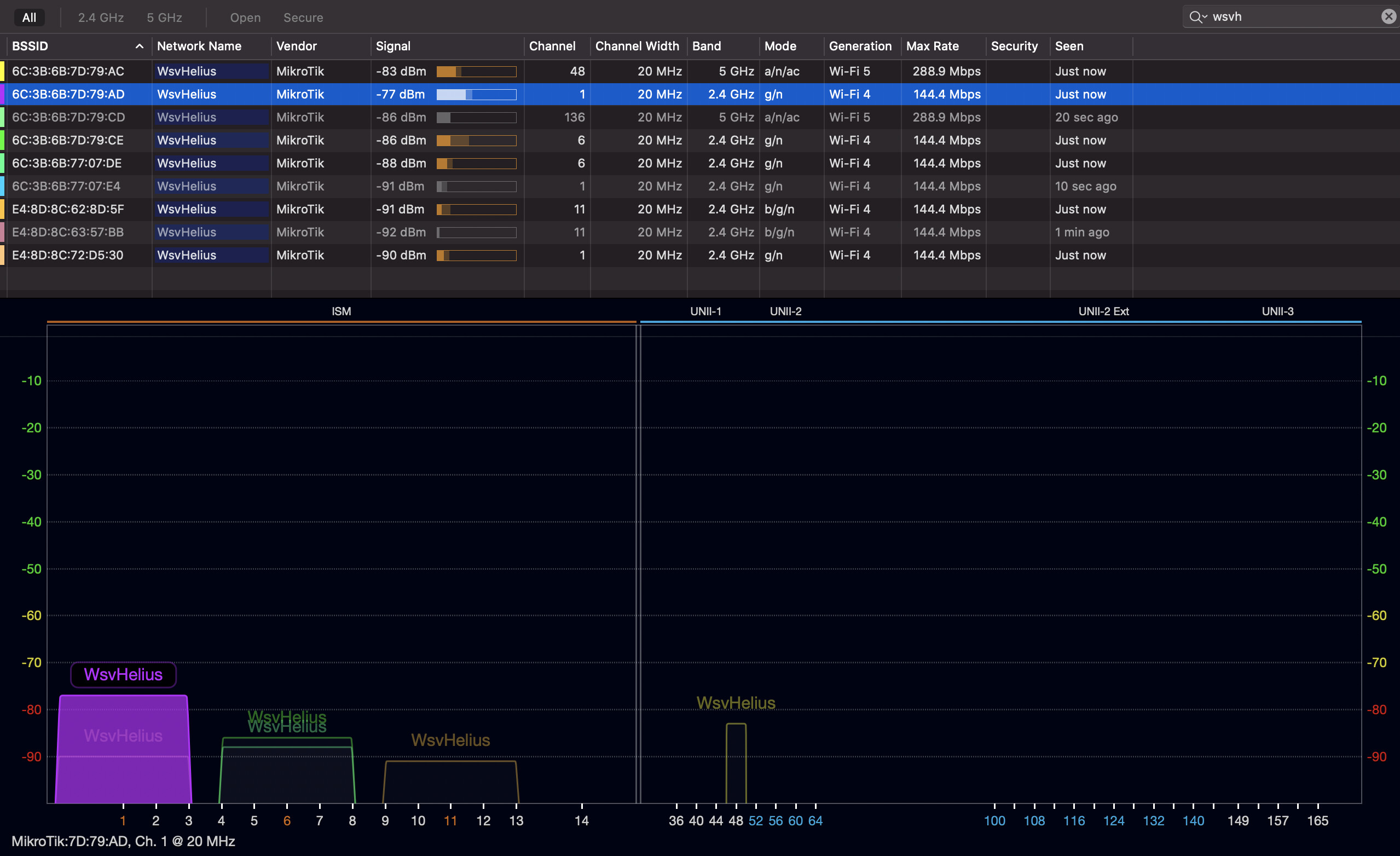

That’s a more general question. Very interesting case. We will have to look at the whole RF spectrum around.
Your information is detailed but filtered, because it was focused on your connection problem, and on “Watersportvereniging Helius”.
The screenshot with channels is filtered on “wsvh” , but the AP search by the client device shows strong “Lovis, Marieke, Marina …” SSID’s in the neighborhood.
Water is a RF signal absorber. Is the weak signal in the boot due to the water or the boot? (Polyester? Metal ? Wood ?) But is most cases it is the client device signal that is weak at the AP!
Many things to explore.
You did not mention the type of Mkt AP you are using.(antenna characteristic) , nor its power setting. (More TXpower will not help, better antenna gain does)

You ar correct, I filtered that Wireless neighbourhood scan result on our own WIFI SSID. There ar for sure other WIFI networks around. The once you listed (Lovis, Marieke, etc) are hotspots on the various boots. That is another probleem. It becomes more and more populair to have a hotspot on the boot to receive the information like wind, speed, GPS, etc. on mobile devices. This is another disturbance factor. I’m not at the harbour at the moment, so cannot easily make another scan. Will try to collect some info remotely and post it here.
The devices I’m using are the wAP devices as the main AP’s on the harbour. I’ve three SXT’s installed as well.
