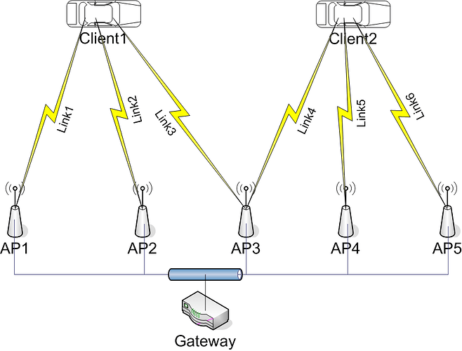

there is a feature update for WDS, which you may call WDS MESH, where the AP (in your case racing car - client) creates a WDS link to all the backbone APs that it sees. And then when the car drives and gets worse signal for the AP where it transmits the data, the bridge will recalculate the path cost and will send the data to the AP whichs has better signal/throughput (less cost).

Instead of dynamic-wds (mesh) I recommend to use static-wds (mesh) as you will have all configured.
And on the car the router will be also running AP mode and transmit the date throgh the lowest cot bridge port (wds interface).
This is what I received from Uldis:
Please take a look at the configuration of your network. I think it should be like that. You have one gateway with ethernet network where you have all the APs attached to it. Each AP is running the same SSID on the same freqeuncy. The APs should have RouterOSv3.0 intalled and it should have wds-mode=static-mesh configured. Then you should add static wds interfaces which will contain all clients mac address. Then you should create a bridge interface on all the APs and set it to rstp protocol mode. After that modify the APs wireless configuration - set the WDS-default-bridge=bridge1 (the bridge that you just created). On the Client AP (car) you should have the same wireless configuration (SSID,frequency,WDS configuration). On the clients APs add the WDS interfaces (all the backbones APs MAC address). Then create a bridge interface with rstp enabled and specify the wireless to use it as wds-default-bridge. On the Gateway router you should specify the bridge priority lower - so it would become a root-bridge. Also note that you should add ethernet interfaces to the bridge you can connect your network device. If you will send multicast traffic then I recommend you to add bridge firewall rules that doesn't send the multicast traffic from client1 to client2, so only communication would be from client1 to gateway. This is all the info you need for the start. After that you can tune the network.
