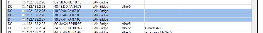

Upon jumping onto the Mtk, I noticed something which struck me as weird and that was I’ve seen up to 10 entries at one point in the ARP table where the TV’s MAC address has shown different IPs.

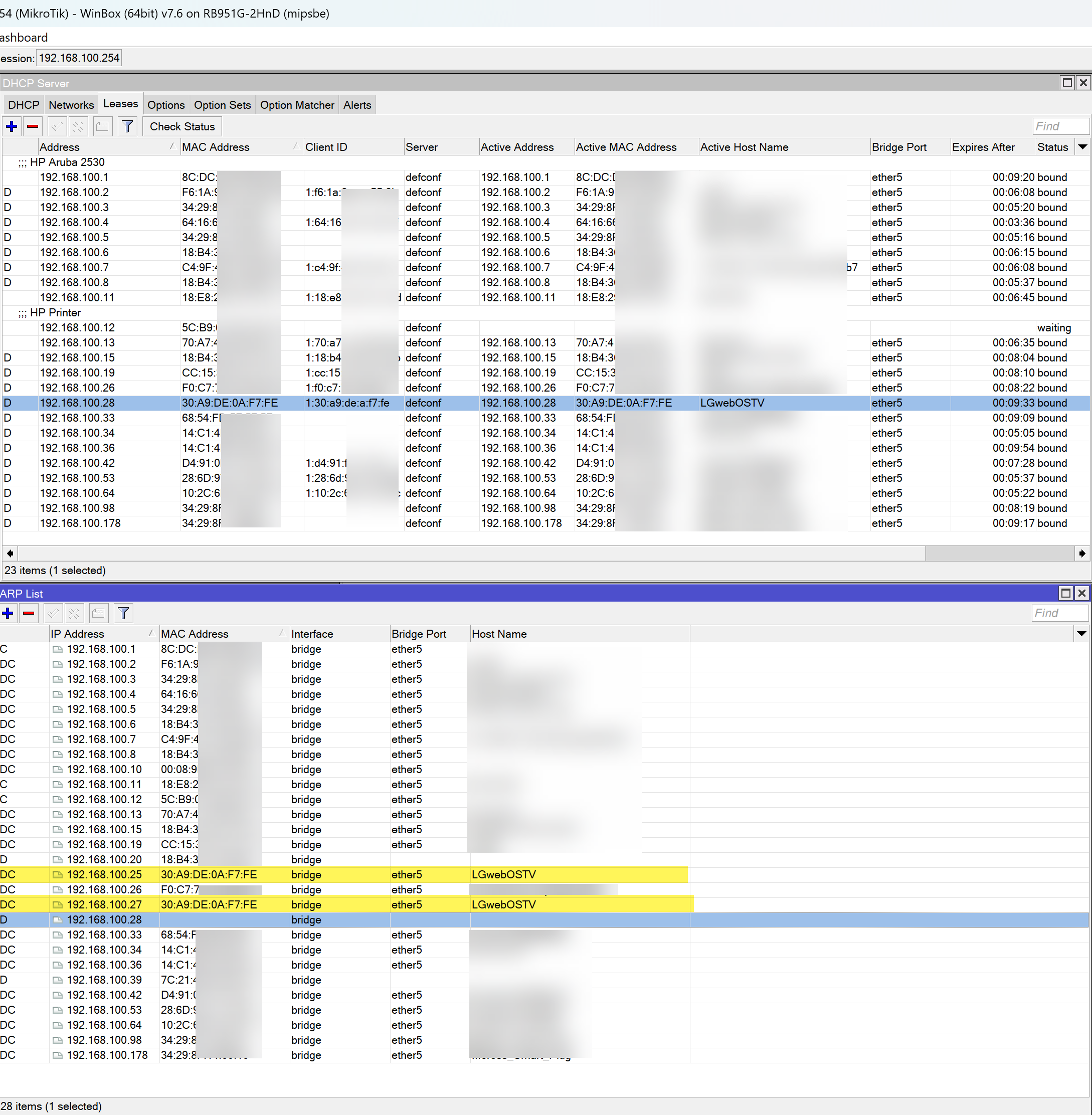

Right now for example, it is showing 2 entries (.25 and .27) where the Bridge port is correct (ether 5) but the 3rd entry (.28) which is the one that actually matches the IP the TV currently has assigned has no MAC, bridge port or host data shown yet when you look at the DHCP leases that is the IP it’s been given.
Screenshots probably explain this better.

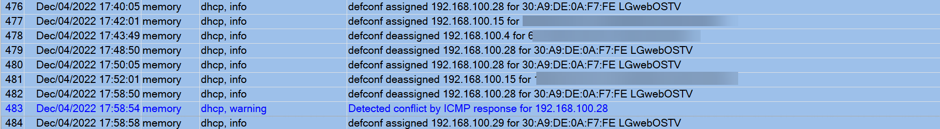

Taking Buckeye’s suggestion, was just looking at the Logs just now and can see:
What I don’t understand is why the TV has clearly had the .28 address, relinquished it at 17:58:50 but then 4s later, there is a complaint of a conflict on that IP, so the DHCP server hands out another one, in this case .29.
This is obviously why I’m seeing so many IPs allocated over time to the TV as it keeps thinking there is a conflict and issuing another IP.
