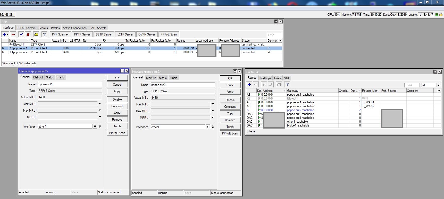

i run 2 pppoe connections at same ethernet (ether1) from 2 different internet providers (2 vdsl modems) without problems. even load balance or failover is working properly.
but your situation may be different as previous post said.
