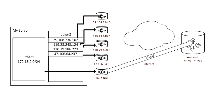

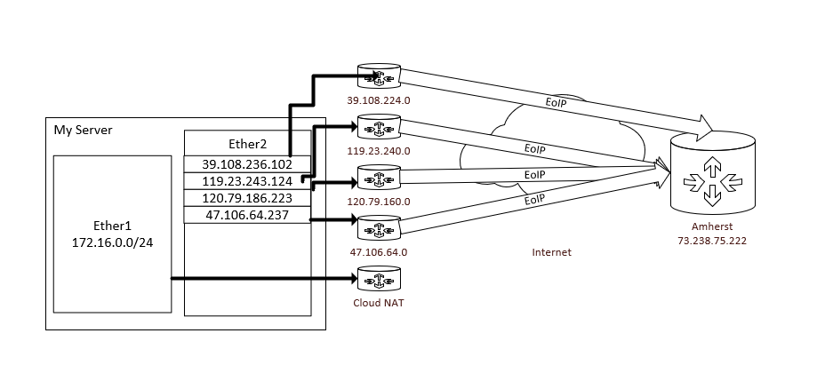

Here is the structure I would like to achieve:
But here is the structure it current is:
Here are my configurations:
