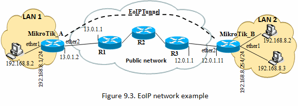

Hi. Have similar setup as EOIP setup example hear. http://wiki.mikrotik.com/wiki/Testwiki/Virtual_Private_Networks
In example there is Mikrotik A and B. My setup include Mikrotik C, D and E. All linking back to Mikrotik A with Mikrotik A having a DHCP and also acting as gateway for all the data. What i am trying to accomplish is to route traffic that is not part of the local subnet out the local interface (different gateway) instead of over the EOIP. In the example this would be over Ether2. Simple, yes? Big problem is that Ether 1 and EIOP is bridged and i can’t seem to find a way of doing this. Any ideas would be appreciated.

Thanks for the reply. That is what i thought as well, however because of the bridge it is not that easy. Also Mikrotik A give ip’s and is also the gateway. Did try to mark packages and route out ether 2 instead of EOIP, but you cant mark ether1 data. It is part of the bridge and the bridge just forward all data to the EOIP.

Also did try this before. Did not actually function, because my filter, filtered DHCP on bridge, which is part of Ether1, braking DHCP on Ether1. Did not however try and fix it because i found the gateway has to be in the same network as ip range, which would any how defy the purpose.
