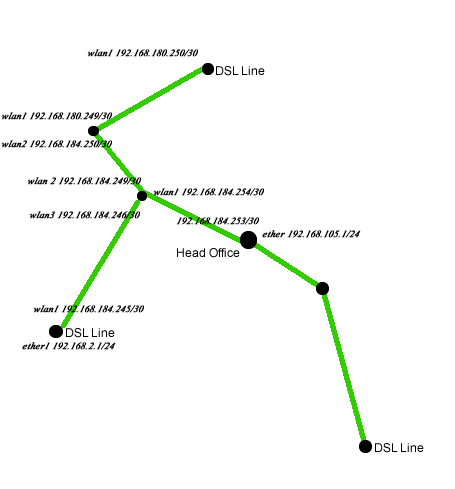

I have a wireless network all controlled by OSPF and everything is running well.
I have multiple DSL lines all at different geographical locations that i would like to load balance my internet traffic over.
Please have a look at the picture and let me know if there is any way that i might be able to get this right?
http://wiki.mikrotik.com/wiki/Load_Balancing_over_Multiple_Gateways
I have checked the link above but it only seems to help if you have more then one line connected to a single router.
Thank you in advance for any help you can give.

What do the two DSL lines connect to before they come to your office? You could put each connection on a VLAN and then that would be your separate interface.
Thank you for the idea I did not think about that. The 2 DSL lines are brought in wirelessly. Each one of the green lines in my picture is a wireless link and the black dots are my router.

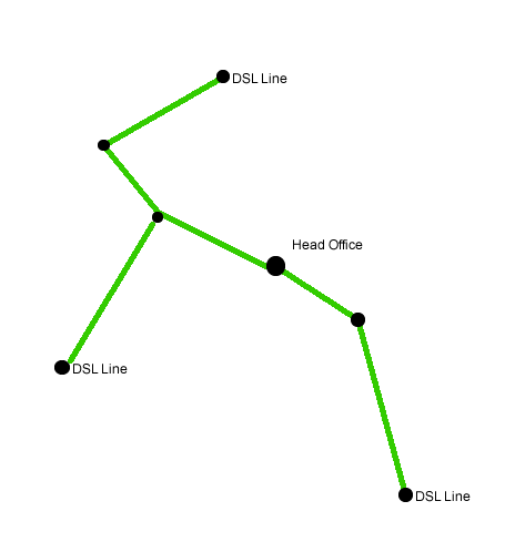

I have updated my picture so you might have a bit of a better understanding.
I have a completely routed network that is across wireless.
Would vlan work in this situation?
