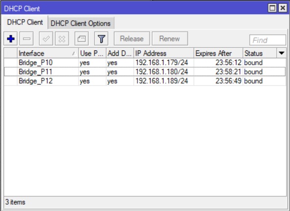

And the resulting DHCP information:
And the configuration:

/ip dhcp-client
add dhcp-options=hostname,clientid disabled=no interface=Bridge_P10
add dhcp-options=hostname,clientid disabled=no interface=Bridge_P11
add dhcp-options=hostname,clientid disabled=no interface=Bridge_P12
