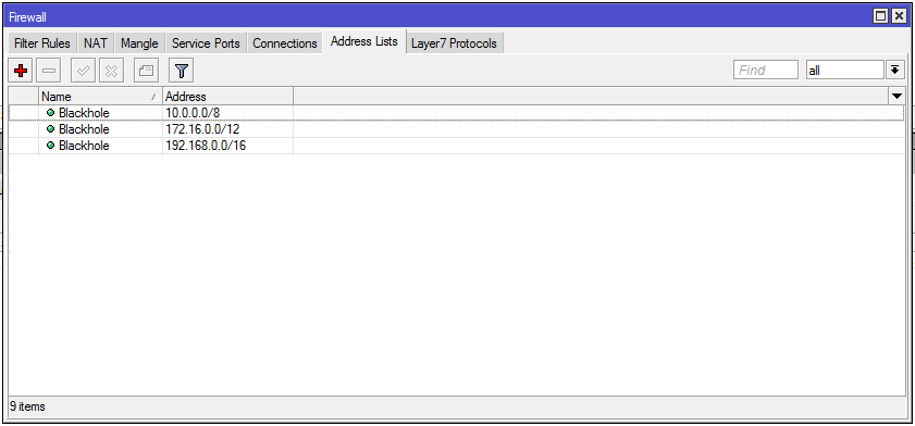

Sorry if my question is basic but I am using Winbox to add IPs to an address list. I am managing to add a range of IPs such as 213.168.xx.xx-213.168.xx.xx (xx is a number of course). But I am not succeeding to add different IPs for example 213.168.xx.xx, 213.168.xx1.xx1 etc. How can I separate the IPs since “,” does not work. Thanks
Just add multiple lines using the same Name:
This works for Subnets, Ranges and single IPs.
