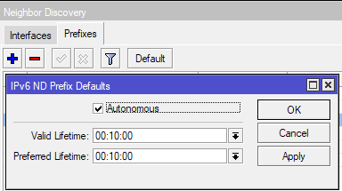

/ipv6 nd prefix default
set preferred-lifetime=30m valid-lifetime=12h
You currently have the default value for “valid-lifetime” set to 12 hours. Which means the addresses with the old prefixes will stay in deprecated states for up to 12 hours before they disappear. If that bothers you, you can reduce the default value for valid-lifetime (it should be greater or equals to preferred-lifetime). On my routers I have both values set to only 10 minutes without encountering any problems.
THanks, I’ve changed the valid-lifetime and preferred-lifetime to 10 mins. And I see that the “c” address shows as deprecated. I’m wondering why it would still be around, long after 12 hours have passed since my initial config changes.
