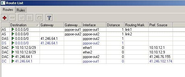

Is there anyway to setup 2 dsl modems connected to a rb450 on ports 3+4 and 2 lan cables connected to ports 1+2,
use the following senario
lan 1 uses a pppoe username dialing out on port 3
lan 2 uses a pppoe username dialing out on port 4
basically what i want to do is anything from lan 1 must leave and return through the pppoe connection on port 3
and lan2 goes and returns on port 4
They do not need to see each other.
I got the dial up working on a single connection, however when i connect both pppoe-clients, they both get the same gateway ip address from the telecom provider, different ip address though.
How do i get this fixed?
I have attached the route list
