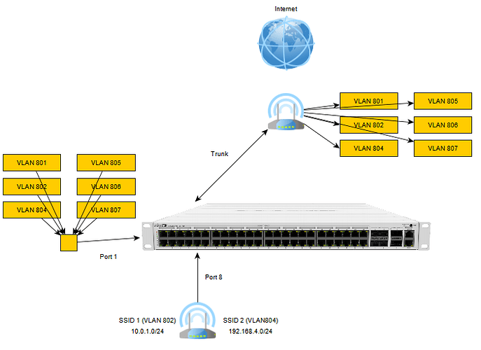

Thank you for your response. Indeed I have read this excellent article, but I think I was not able to pin point
a similar setup with the one that I am looking for.
In regards to the missing configuration, I am trying for the time being to focus on only one access point in order
to get my self familiar on how to proceed with the rest of the configuration. As soon as I will have this on AP up and running
the plan is to group the rest of the ports accordingly.
I tried to made a brief drawing as you have requested, that depicts the current setup.
