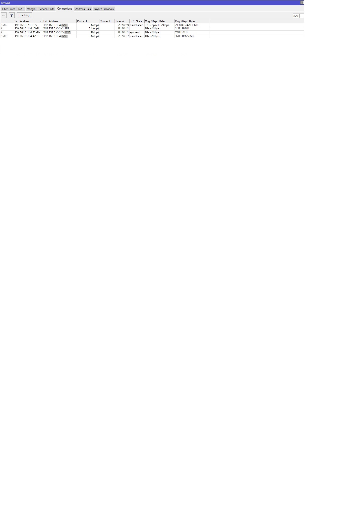

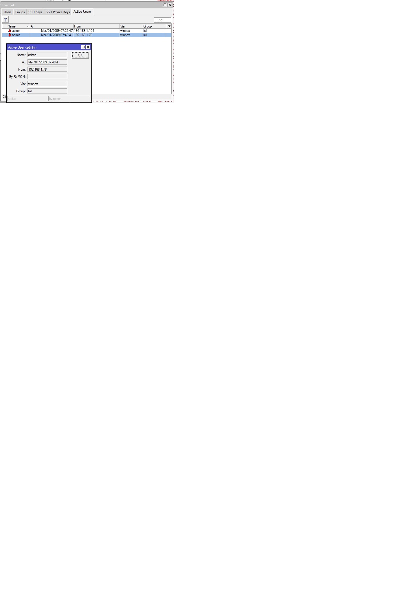

I am hoping to get some assistance with an issue that I can’t seem to figure out with regards to seeing one or two users active in the users list when I log into winbox as I am the only user to this router. I installed RouterOS version 6.35 and run the dude on an x86 server and whenever I log into via Mikrotik winbox and check the connections list in the firewall I see that I am connected however I then see the IP address of the router connected to itself (Source Port is different but the Destination Port is 8291). I followed some steps and did the following to tighten up the security however the results are the same:

I’ve attached some images to show what it is that I’m seeing and I would greatly appreciate any assistance that can help direct me to resolving this issue. Thanks in advance to anyone that can assist.

Create new account with different username and password. Disable damin account and see if it happens again. If it still happens, reset configuration (try not to back up old setting to resetted router). I don’t think there are any miracles…
