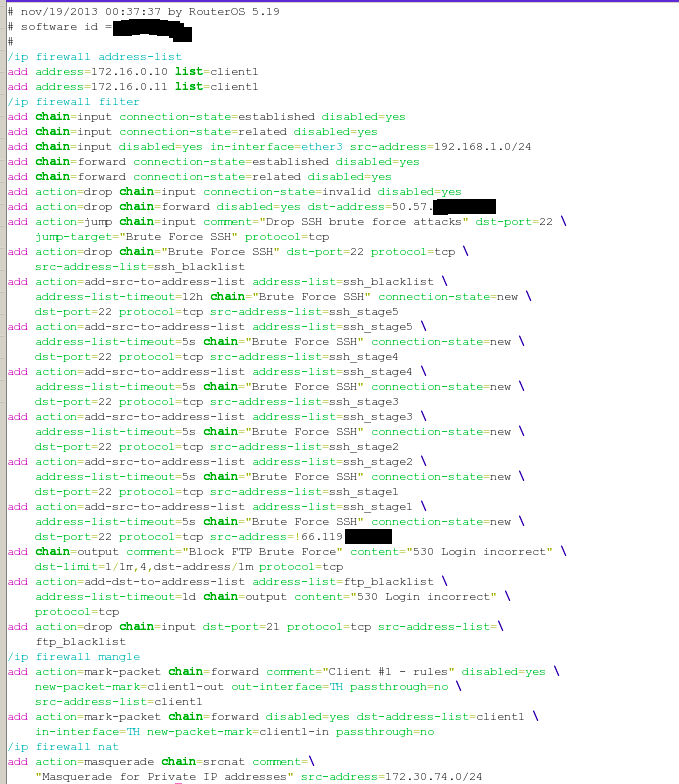

Yes, I have the same filters applied. Here is my ROS filter with a few of the IP’s I am trying to get rid of:
add chain=input connection-state=established
add chain=input connection-state=related
add chain=input connection-state=new
add chain=forward connection-state=established
add chain=forward connection-state=new
add chain=forward connection-state=related
add action=drop chain=input connection-state=invalid
add action=drop chain=output out-interface=TH protocol=gre src-address=108.66.160.187
add action=drop chain=output out-interface=TH protocol=gre src-address=107.223.149.47
add action=drop chain=output out-interface=TH protocol=gre src-address=69.29.90.86
add action=drop chain=output out-interface=TH protocol=gre src-address=72.16.15.213
add action=drop chain=output out-interface=TH protocol=gre src-address=70.182.28.60
add action=drop chain=output out-interface=TH protocol=gre src-address=70.166.130.156
add action=jump chain=input comment="Drop SSH brute force attacks" dst-port=22 jump-target="Brute Force SSH" protocol=tcp
add action=drop chain="Brute Force SSH" dst-port=22 protocol=tcp src-address-list=ssh_blacklist
add action=add-src-to-address-list address-list=ssh_blacklist address-list-timeout=12h chain="Brute Force SSH" \
    connection-state=new dst-port=22 protocol=tcp src-address-list=ssh_stage5
add action=add-src-to-address-list address-list=ssh_stage5 address-list-timeout=5s chain="Brute Force SSH" \
    connection-state=new dst-port=22 protocol=tcp src-address-list=ssh_stage4
add action=add-src-to-address-list address-list=ssh_stage4 address-list-timeout=5s chain="Brute Force SSH" \
    connection-state=new dst-port=22 protocol=tcp src-address-list=ssh_stage3
add action=add-src-to-address-list address-list=ssh_stage3 address-list-timeout=5s chain="Brute Force SSH" \
    connection-state=new dst-port=22 protocol=tcp src-address-list=ssh_stage2
add action=add-src-to-address-list address-list=ssh_stage2 address-list-timeout=5s chain="Brute Force SSH" \
    connection-state=new dst-port=22 protocol=tcp src-address-list=ssh_stage1
add action=add-src-to-address-list address-list=ssh_stage1 address-list-timeout=5s chain="Brute Force SSH" \
    connection-state=new dst-port=22 protocol=tcp src-address=!66.119.x.xxx
add chain=output comment="Block FTP Brute Force" content="530 Login incorrect" dst-limit=1/1m,4,dst-address/1m protocol=\
    tcp
add action=add-dst-to-address-list address-list=ftp_blacklist address-list-timeout=1d chain=output content=\
    "530 Login incorrect" protocol=tcp
add action=drop chain=input dst-port=21 protocol=tcp src-address-list=ftp_blacklist

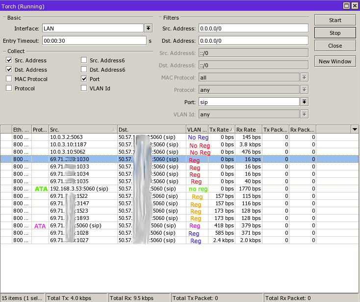

Here is an update that may prove useful.
The torch image I have posted shows all SIP customers and their related source and destination info. I color coordinated the accounts so you can see how they are connecting.
As you can see in blue, two host phones connect while one does not. Same applied to red and even one customer with just an ATA is failing to register. Two others, gold and purple, are linked up fine.
Note the source NATed outbound IP of the no-reg’s. They stay local and have no transmit traffic while those that do register, NAT appropriately and function.
This pattern will change too. Gold will drop one while red will gain one for example.
I am still digging on how to proceed from here but hope this behavior trips an idea from someone that has seen the issue before.

You should enable the display of the reply-dst and reply-src addresses in the Connections list. That might show you something interesting.
Source NATing is just not happening correctly. The SIP server does not want to associate with the LAN IP. Now, how to kick it into correctly operating like it has for almost 2 years?
