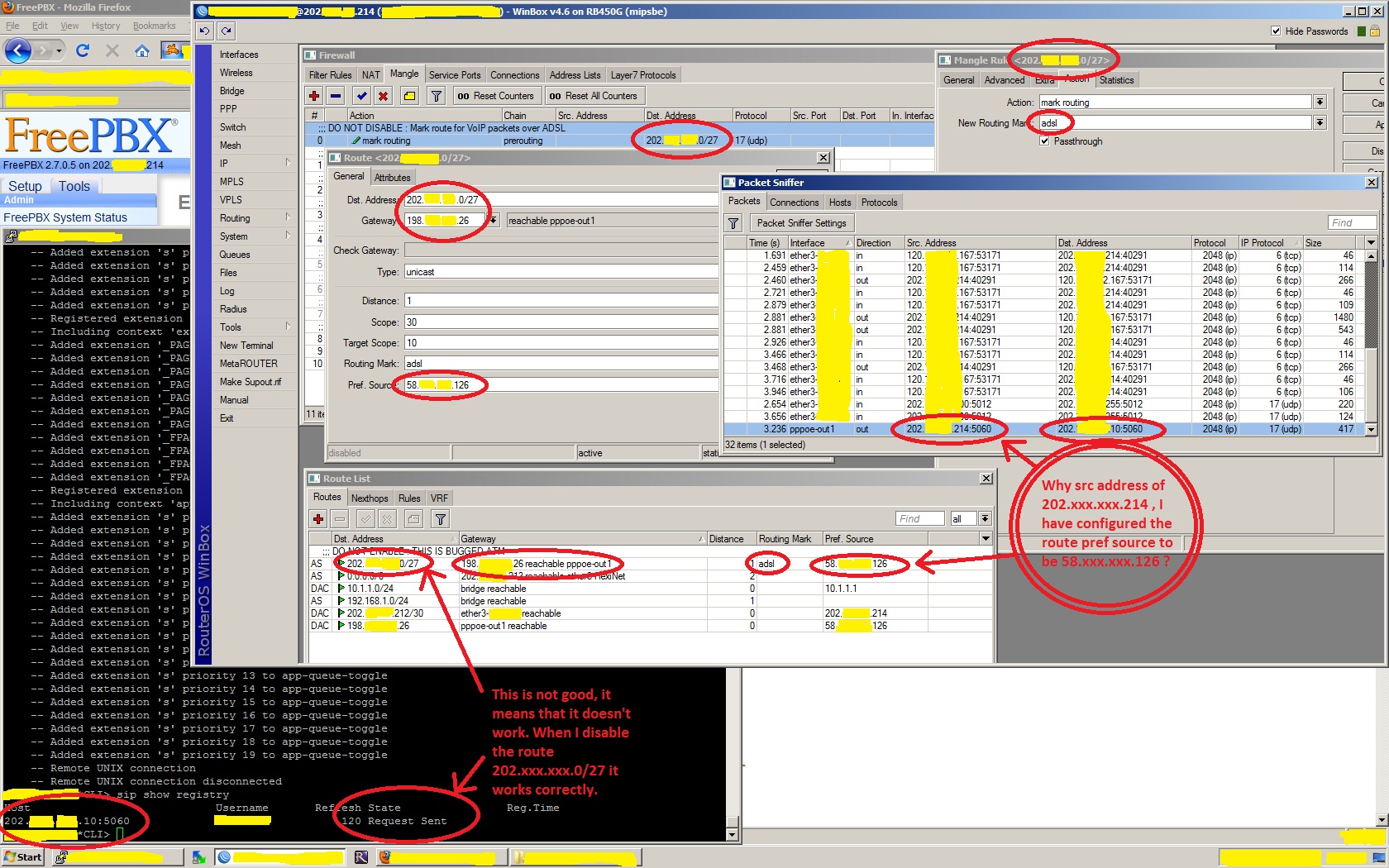

Hi Guys,
Sorry , this is about the same topic as the VoIP Sip routing, but I presume the title scared people off. Simply put, my problem is that I have two uplinks on one RB450G router. I configure a static route to route traffic to a certain IP range over PPPoE ( ETH1) and the rest over default gateway which is ETH2. But, when the traffic goes out through PPPoE ( ETH1) packet tracer says “src address = ”, but used interface is ETH1 ).
See screenshot. Any help appreciated.
Best guess - connected route is used.
I have solved this problem. The solution is here :
http://forum.mikrotik.com/t/problem-route-voip-sip-traffic-over-another-route/45374/3
